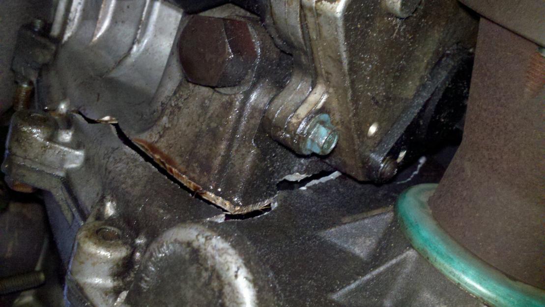

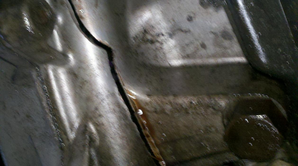

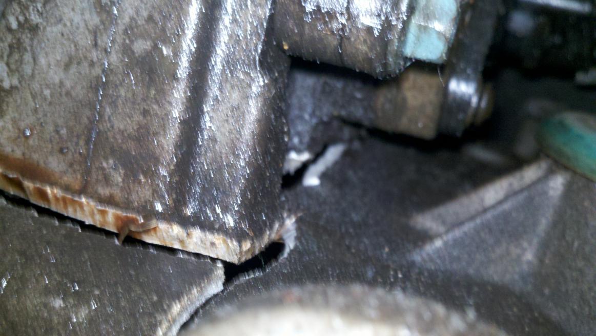

I have a bit of a problem with my transfer case. It has a quarter inch crack in it that runs from the bottom of the case to damn well near the top. If you want to see the damage, please reference the attached photos.
The incident happened two weeks ago. I was driving down the highway at 65 mph and thinking, "damn, for 140k miles, this vehicle is awesome!" Shortly after that, I heard a loud crunch, bang, metal on metal, and continued banging. The front driveshaft dislocated from the transfer case. When I pulled over, I was lucky enough to pull the front driveshaft, shift into 4HI, and make it back to home. I have been driving like this for the past two weeks, with no problems (now I probably will get one) over 300 miles and 3 long trips of 60-70 miles on the highway (averaging 65 mph).
My question to you fanatics is if I need to replace the transfer case if I plan to keep it as a 2WD vehicle? Up to this point, I have had no problems (there I go jinxing myself). With the front driveshaft removed, is there any need for the transfer case or to worry about problems.
I am sorry if I sound like a n00b, but a replacement is running $550 (used) and I don't have the cash to do that, nor buy a new vehicle. So basically, can I continue driving my vehicle with the aforementioned crack?

Back to the problem, IMHO I don't think you'll be doing any more damage than what's already been done, but I would be fearful of what happened if the transfer case locks up or decides to self destruct. Also, since you don't have the $$$ for a new case or replacement vehicle, it sounds like your choice has been made for you! Keep an eye on CraigsList, junkyards, etc. Maybe you'll be able to get one cheaper.

you cannot leave the transfer case in its current state, it WILL end up seizing up without any fluid in it the question is WHEN NOT IF.
if you wanted to convert the truck to 2wd you would need to pull out the t-case and get a 2wd drive shaft to go to the rear, that said your best and easiest (not necessarily cheapest) solution is to replace the t-case. Models from 01-03 durangos should fit as should 01-04 dakotas, im not sure about any others, but a user by the name Master Tech works for a dealer and can reference the case to your truck if you get him the part number.
