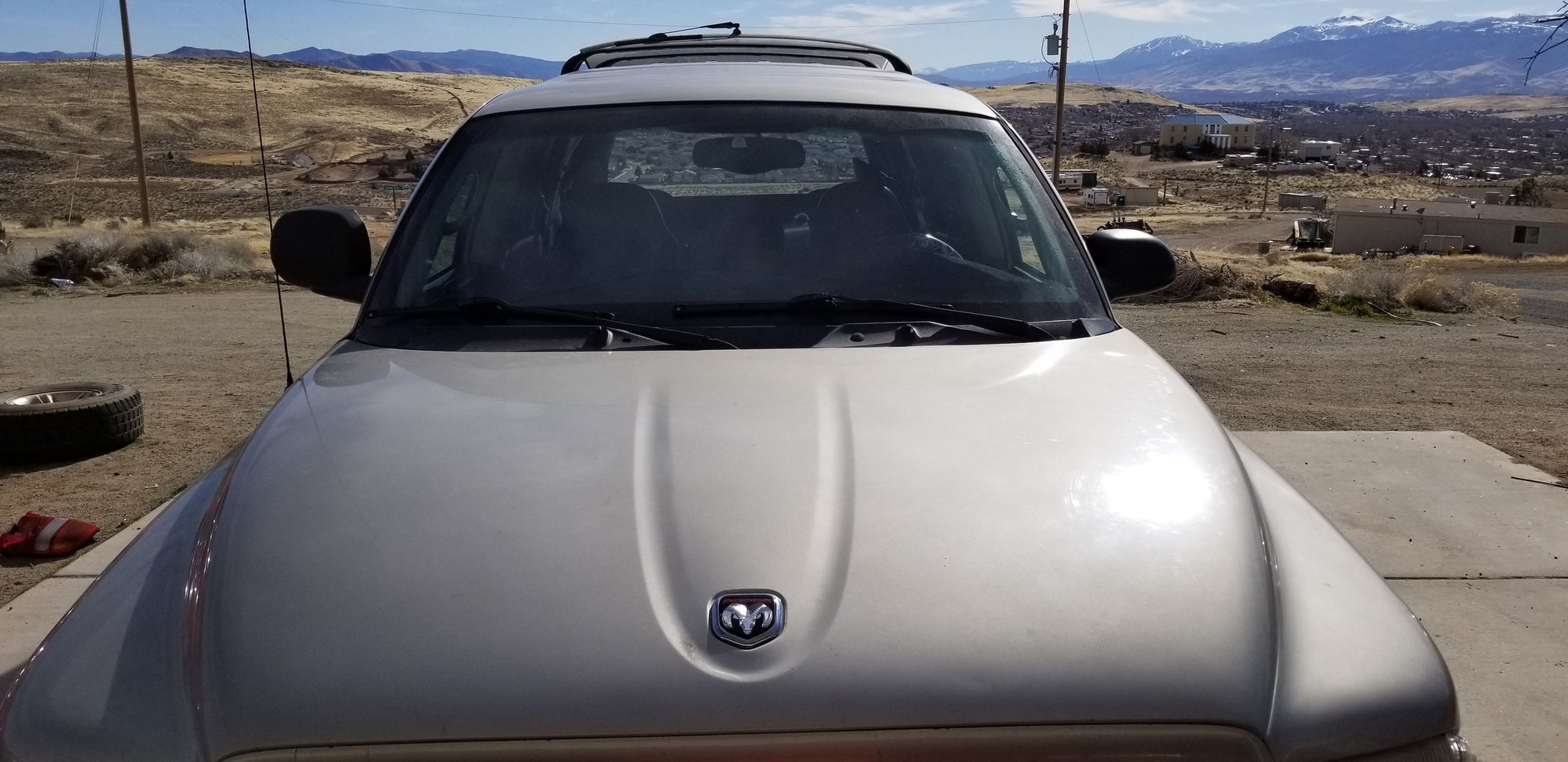

Finally got around to finishing installing my 2000 Durango heated mirrors on my 2001 Durango SLT+. Wife and are loving the bigger mirrors...it's amazing just how much more visibility there is. I have 2 pic, one with just the passenger mirror replaced and on with both finished. Thanks again for this thread Also, you can see the custom mount for my GPS I made as well in these pictures.
Edit: to the left on the finished project picture you can see Durango #3...#4 is tucked down below...seems your first Durango is a true gateway drug LOL. During the installation process with only the passenger side mirror changed out.
Finished project
