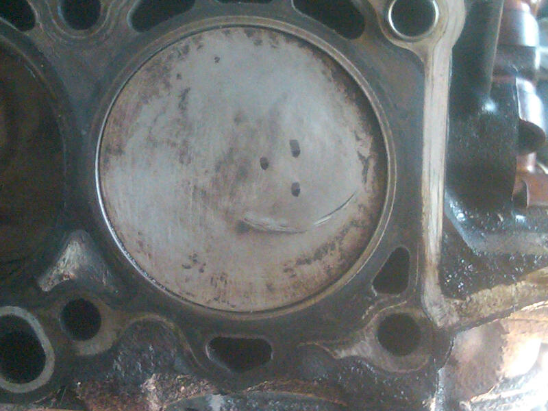

Posts: 28
piston has a small smiley face worn into the surface...should be fine. ran into problems getting the exhaust manifold off the head---busted a bolt in each and cannot get a hold on most due to the severity of rust. since i am taking to a shop any way, i hope they dont charge me to much to have the manifolds removed. I sure as hell am not gonna stick 250 into new ones. Need to find some new bolts, but maybe shop will take care of for me. $160 to have the valve job + parts, then comes the rebuild! I will try and post a pic of the blown seat and the smiley face. Thanks again!

trying to be funny, but I got reeeeeeallly lucky i think4.7 no compression-sohappy.jpg

Yea I think you'll be ok on that. Just ensure you have the same clearance all around the piston to the cylinder wall.

trying to be funny, but I got reeeeeeallly lucky i thinkAttachment 13714
Yes, you did get lucky!!!! It could have just as easily punched through the piston face and caused a bunch more damage. Don't feel bad about mising the front bolts, I spent an hour trying to get mine off too cause I missed the lower front one. Easy to do.
