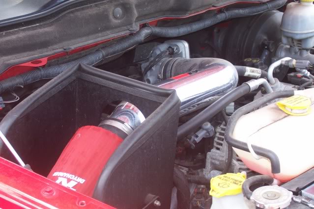

Here is my seven year old K&N (note I have a pre-filter because where the farm is in south Georgia the dirt road to paved road ratio is about 50/50. Red clay dust will do a number on the filter fast and dirty up the oil pretty quick).

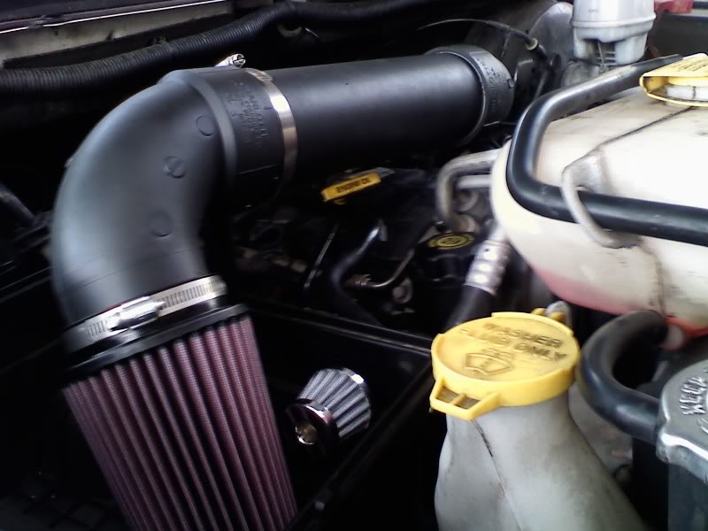

And a couple I made for members here:
