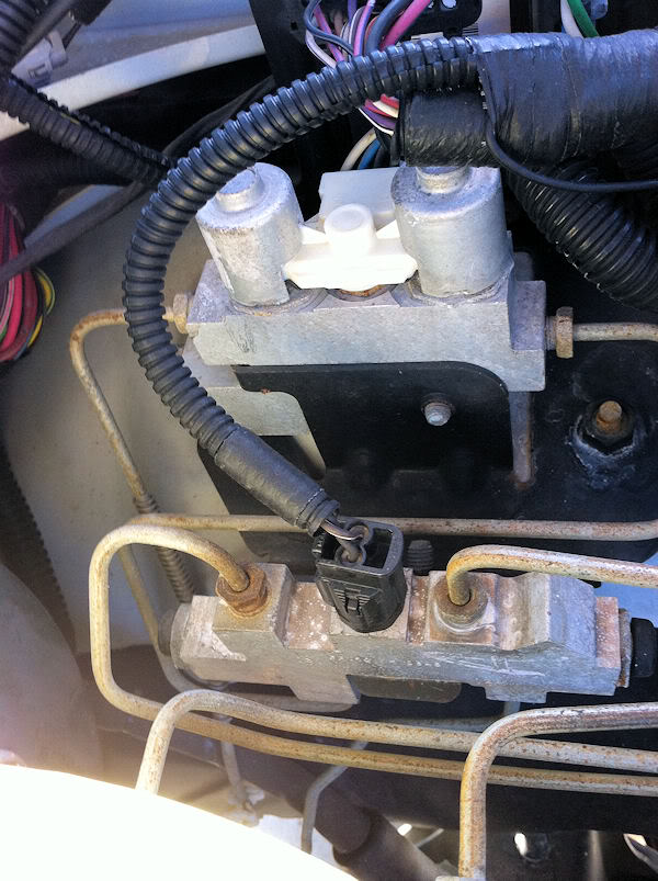

Not to hijack the thread but was 2003 the only year for disc brakes? What model were they on Dakota and durangos? I know on my 99 Durango the is a straight brake line that runs from the master cylinder block to the rear rubber hose splitter box. I had to replace that brake lone that feeds the rear axle. Napa wanted 150 for it. I said nope and bought. Standard brake line and a tubing bender it took 2 6 foot peices. There was nothing on my frame rails.I seen some where u can buy a proportioning vavle to adjust rear brakes maybe u can add one of those inline to lower the pressure.
The shop that installed my gears and axle swap said they would need to install a proportional valve that could be adjusted. He said they would adjust the amount of fluid between the front and rear discs.
I will swing by there today and talk to him to see exactly what this method is and where this part comes from. I have not had it put on mine, as I have not had Soopers problems. Not sure yet that when I change my booster out if I will have them.
Pic of valves I just took.
