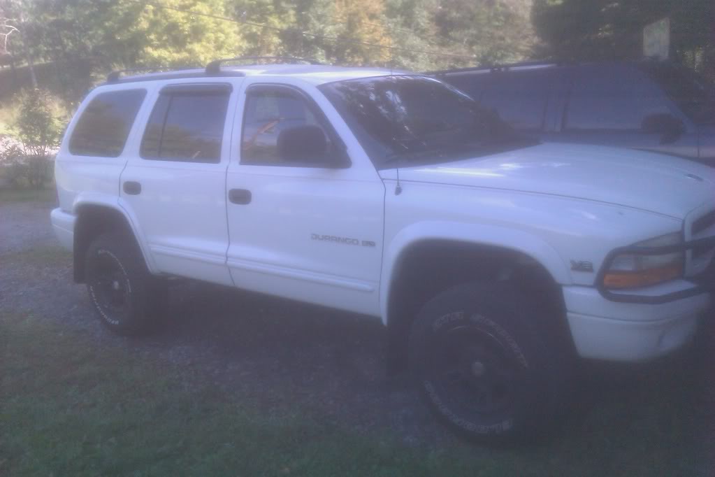

Old Sep 17, 2011 | 03:02 PM
Irondime's Avatar
Irondime
Joined: Sep 2011
Posts: 81
From: NE Ohio

thats not a bad looking truck you have there... (although i can't stand all black wheels..just MHO) get a good exhuast systen, tune-up and fluids changed and it looks like you will have a pretty sweet running ride
