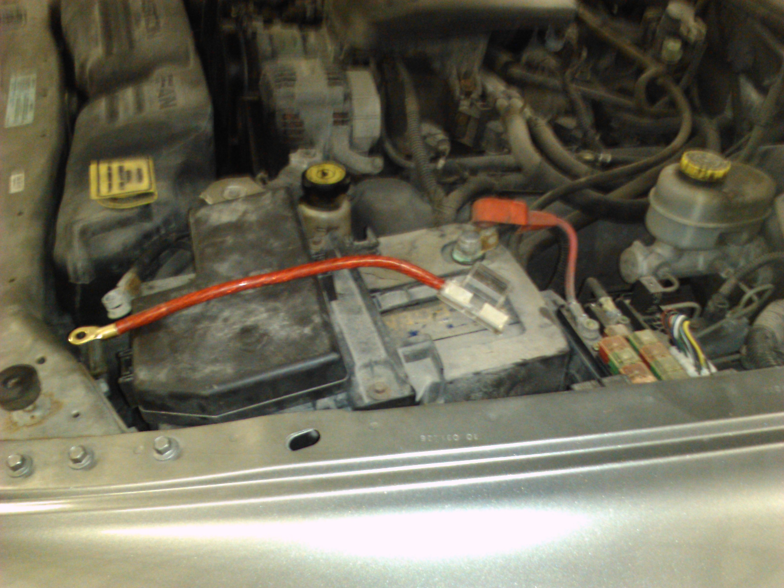

I'm confusing myself it seems. Isn't the one pictured above carbed? Or does it just look like it?
Bad picture angle but the only one I've taken while under the hood. Valve covers are different and the air intake is different.

No carbs all 5.2 and 5.9's in the Durangos of all years are multi port fuel injected.
That fuzzy pic you have there looks like a 4.7 OHC to me. (No carbs on those either)

Should there be a little sticker under the hood that identifies what is in it? I know nothing about how to identify these motors.

On the 5.2 and 5.9 there is a yellow sticker on the front of the drivers side valve cover. Not sure on the 4.7, but the 4.7 is distinctly different as it is an over head cam motor, the round bulge on the front of the valve cover is for the cam drive sprocket... among many other differences.
