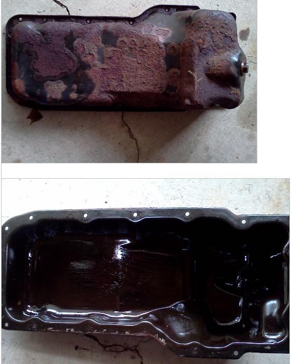

I recently replaced the engine oil pan on my 2001 Durango 4WD w/ the 4.7. The oil pan was looking very rusty and I was worried that it might start leaking over the winter. I live in the Cleveland, OH, so rust progresses at an alarming rate. I was hesitant to do this job because I thought the manual made the job seem easier than it was in reality. I also couldn't find any postings online where someone else had actually done the job. All I kept finding were people posting the same info that's in the repair manual or people saying "it's really hard because the front axle has to come out."

Now I was at the pan, I just needed to remove the pan bolts and hope for the best. All of the bolts came out without a problem, they must be high quality bolts. I really feared that a few would break. With all of the pan bolts out, the pan wouldn't budge. I hit it with a hammer, still nothing. I was able to tap a gasket scraper with a hammer and wedge it in between the pan and gasket to help break the seal. Remember to wedge the scraper in between the gasket and pan NOT the gasket and block, you'll understand why in a moment. I was able to go around most of the pan with the scraper to break the seal, I wasn't able to get at the rear of the pan right away. The pan seemed to be coming down at the front and side, but the back wouldn't budge. It actually seemed like there was something inside the pan pulling it upwards. Every time I pulled down, the pan would spring back up. It turns out that since the pan gasket has a windage tray built in, and the windage tray is bolted to the inside of the block, the rear of the gasket still being "glued" to the pan was causing the pan to spring back up. This is why I said earlier to break the seal between the pan and gasket and NOT the gasket and the block. I kept working with the scraper to break the seal at the rear of the pan. Once I finally worked the scraper all of the way around the back of the pan, I was able to lower the pan a few inches.
Immediately I noticed there was no way I was going to have enough room to reach into the pan to remove the oil pickup tube bolts. Also, I noticed that I could drop the rear of the pan, but there wasn't enough clearance to slide it out past the transmission. I think I would have only needed it to drop another 1/4" or 1/2" to get it to slide out, but there just wasn't enough range of motion. I noticed that the front of the pan was being held up by the rack and pinion. I removed the 2 large bolts that attach the rack and pinion to the frame (it did not affect the alignment) and the rack hung down far enough that I was easily able to slide the pan out, leaving the pickup tube and windage tray in place. This was a good feeling. This post has a pic attached where you can see the two bolts that hold the rack and pinion to the frame. Notice the shiny new pan installed.
I removed the pickup tube, it's just held in place by a few nuts and a bolt, and then the windage tray/pan gasket came off. I cleaned the block mating surface with some brake cleaner and a rag then positioned the new windage tray/pan gasket and reinstalled the pickup tube, making sure to install the new pickup tube o-ring that came with the gasket. This was straightforward, I just made sure that the bolt holes in the windage tray/pan gasket were lined up with the holes in the block before I torqued down the pickup tube nuts/bolt. I cleaned up the oil pan bolts with a wirewheel grinder, they looked great. I was able to reinstall the pan without a problem. I can honestly say that reassembly was just the reverse of the removal process (just make sure to torque everything to spec and remember to follow the torque sequence for the structural cover bolts).

One neat thing I noticed was that there was no sludge in the oil pan, it was clean with just a film of oil left on all the surfaces. The engine has almost 180K miles, so I felt pretty reassured that the previous owner had kept up on the oil changes. I did also notice that the inside of the pan looked perfect, so I wonder if I really even needed to replace the pan. The outside looked pretty bad, so I'm glad I did it, because I have a feeling it would have started leaking in the middle of winter had I left it alone. Now I have piece of mind. This post has a pic attached of the inside/outside of the pan.

damn, the outside of that pan looks bad,
