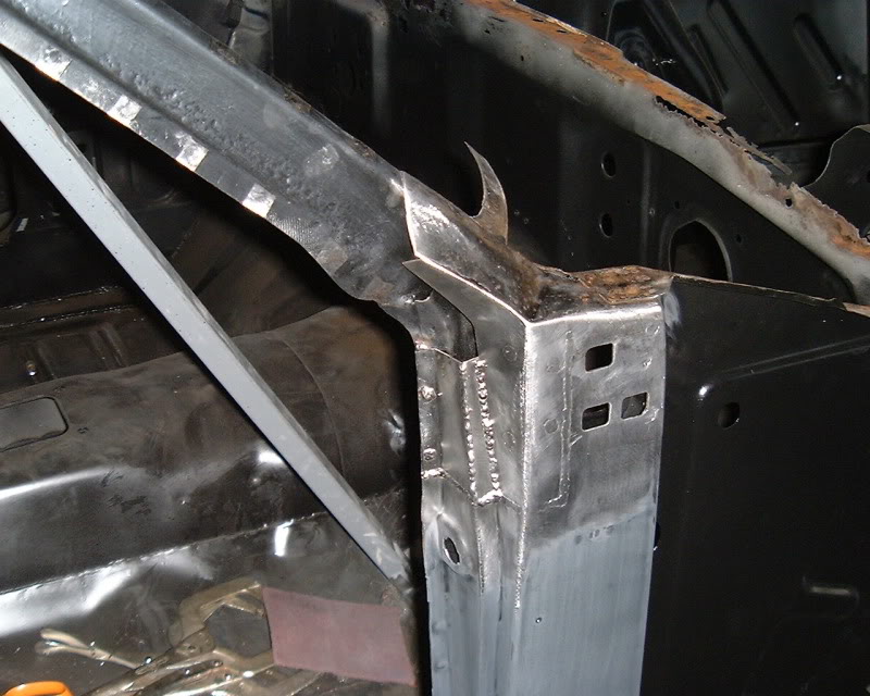

Old Feb 9, 2012 | 11:54 AM
Bobman's Avatar
Bobman
Joined: Sep 2010
Posts: 396
From: Buffalo, NY
C'mon.... no guts no glory!!!!
It's not from a D, but anything is possible.
Bob
Attached Thumbnails fixing rust-before.jpg   fixing rust-during.jpg   fixing rust-after.jpg

Surprisingly it's not that tough to do with a little practice. In the case of my Mustang, there was so much rot on the unibody parts of it that I had no choice but to cut and weld pieces in. Pretty much any panel is available for it, but in the case of the doorpost shown the amount of work to patch was far less than the $$$ and labor to replace the post. It's also a hobby and labor of love, not a daily driver!
A cheap mig welder is good enough for the average user (mine is a used Miller) and I do a lot of fitting with paper templates before metal is ever cut. The tighter you get the fit the easier the weld is, and the less grinding to be done afterwards.
Still, if you can get a bolt on panel in good shape you ar FAR ahead of the game! Bottom line.....rust sucks to repair no matter where it is!
