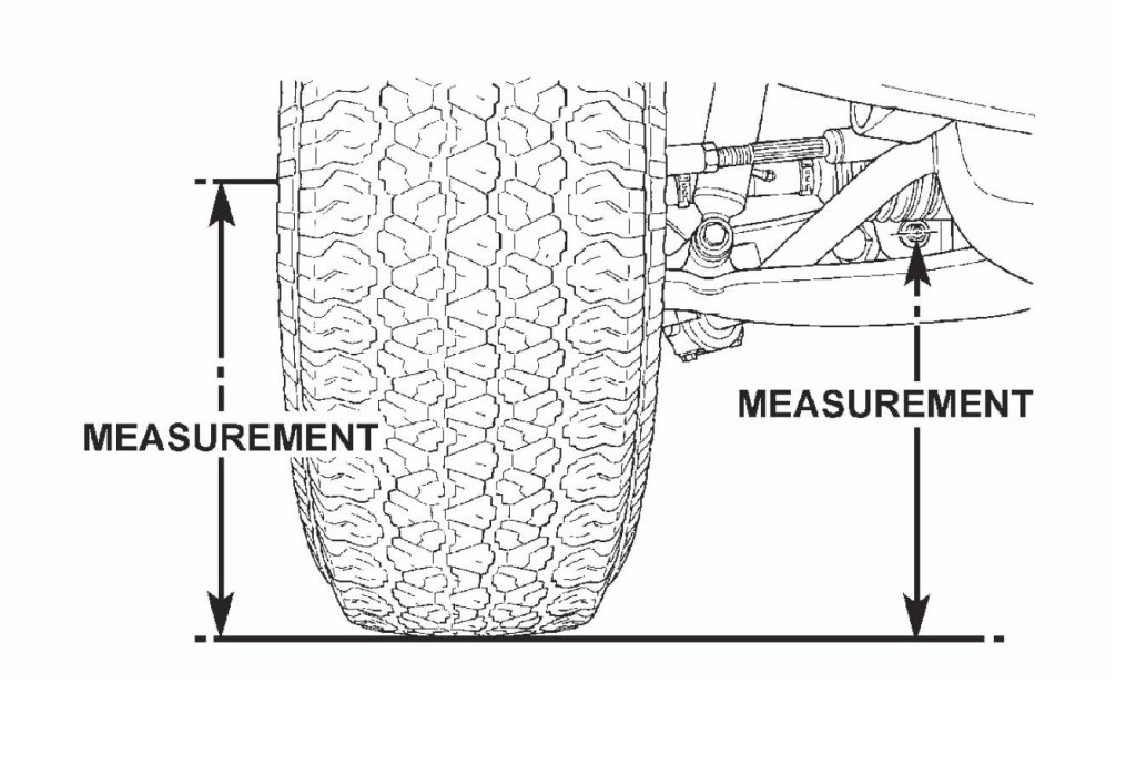

No that is not right. .12" is the variance, not the correct measurement between the points of measurement.
I will try to explain in more simple terms. You measure the height from the ground to the center of the front wheel. I have found the best way to do this is to remove the center cap from the rim and using a level set the one end to the center of the wheel bearing bolt, then measure from the ground to the other end of the level using a yard stick. You have to ensure the level bottom or top is directly centered to the exact center and level over to the yard stick. Now write down this measurement because it wont change.
Next climb under the front of the tire (forward facing) and find the hexagon end were the torsion bar plugs into on the lower control arm. Mark a center line with chalk. Note, the angle is not straight on the hexagon so measure both sides and accurately draw a center line. Now measure from the ground to the center of this hexagon and write that measurement down. As you adjust this number will change.
Now subtract the difference between these 2 measurements and that should equal 2.9" or 73mm. I like to convert the measurement to mm because it is a lot closer to me, but each to their own.
Now you don't exactly need to be at 73mm or 2.9" (which is the same thing). There is a small bit of variance allowed. This variance is plus or minus (+/-) .12" or 3mm (which is the same thing). So if you measure it and get a 70mm you are within specifications (the variance). Same thing if you measure it and got 76mm, you are still within the specifications.

Here is where you take the measurements to ensure it is being done correctly.
