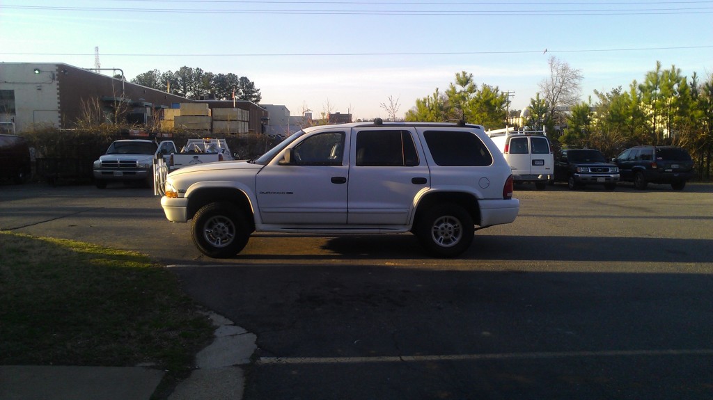

Old Feb 28, 2012 | 07:25 PM
TurboStixx's Avatar
TurboStixx
Joined: Oct 2011
Posts: 646
From: Richmond, Virginia
Here is the truck, this is before leaf spring helpers, will take a picture for the after

That was before, I am within 1/4 of each other now. But the rear still massively sags, and I was looking at putting a 3 inch block on the springs, but since my springs run under the axle not on top, won't that just lower it?
