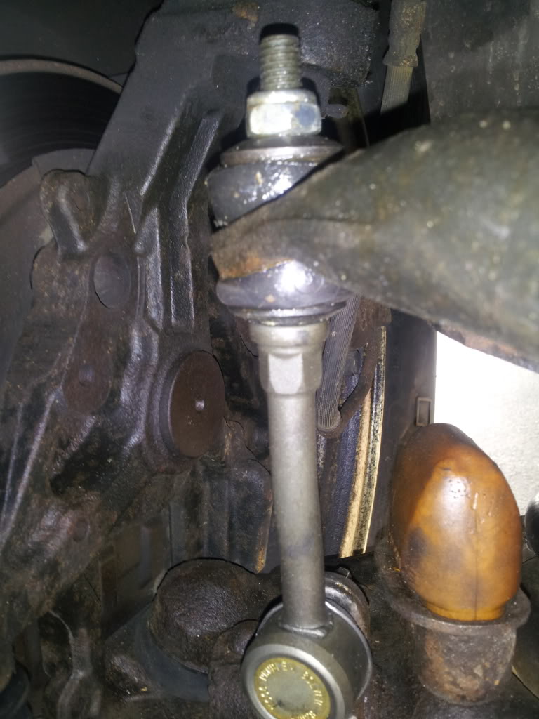

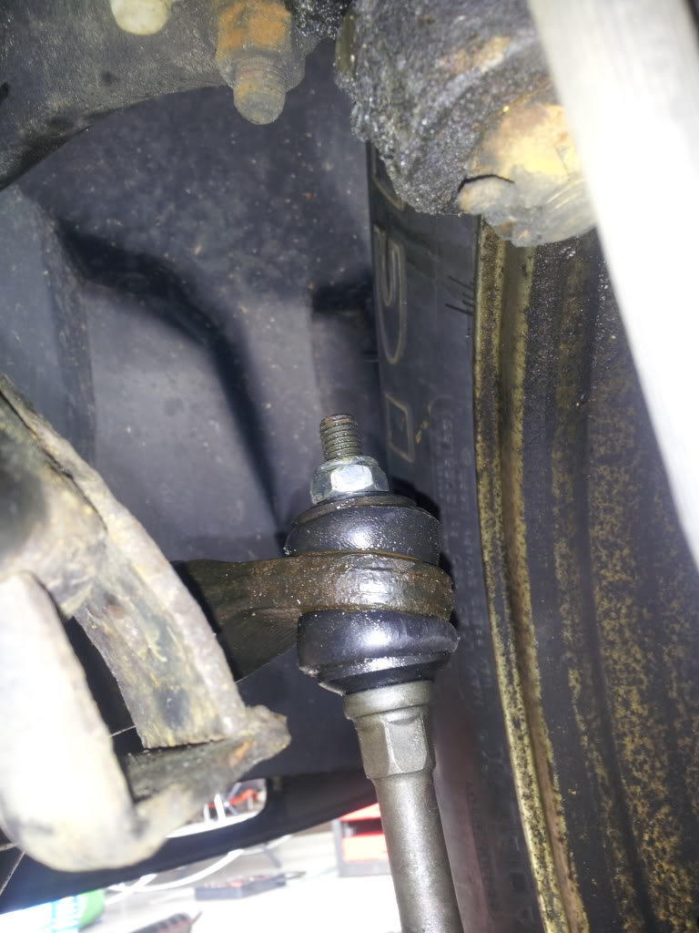

here are the fronts that were removed from the truck...

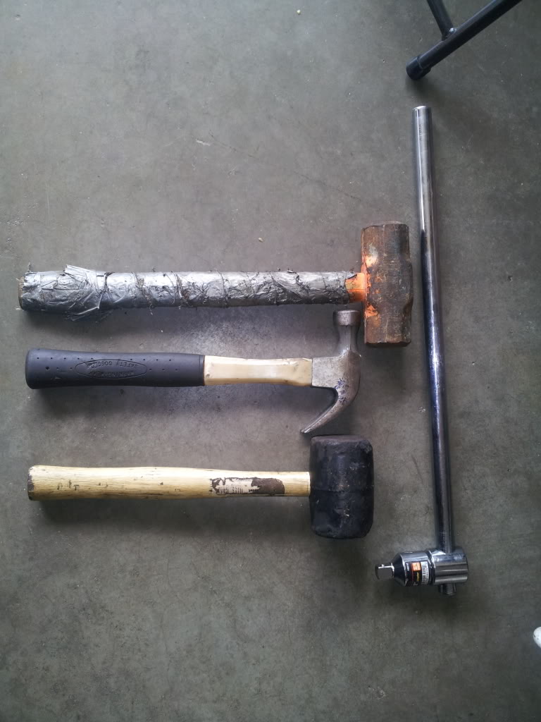

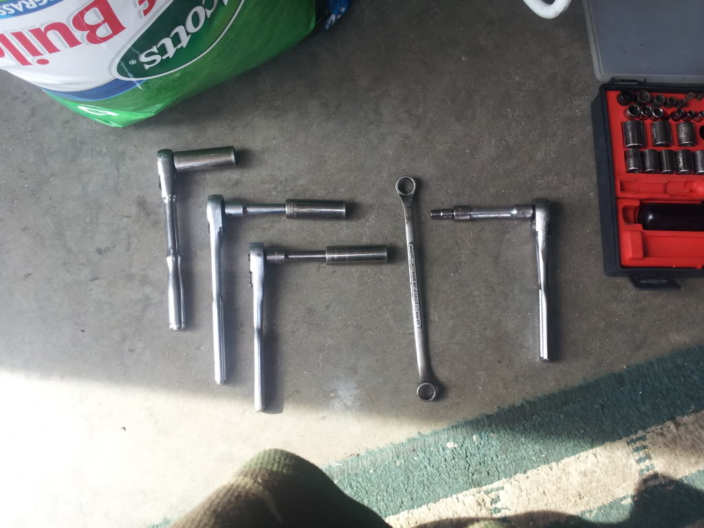

the tools that were used to remove everything

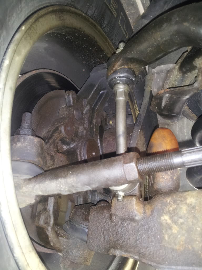

if i remember i used the 15mm socket and the 16mm socket to remove the old ones and a 17mm socket and a combination of a 15mm wrench and 8mm socket (control arm side) to install the new ones. i also used a different combination of ratchets and extensions to get it all off and on. the hammers, mallet, and breaker bar were used to pound the old ones out of the control arm. the screwdriver was used to remove the brackets off of the bushings. also, i used at least half a can of wd-40 on this whole process (front and rear bushings and front end links).

From: Romeoville, Illinois

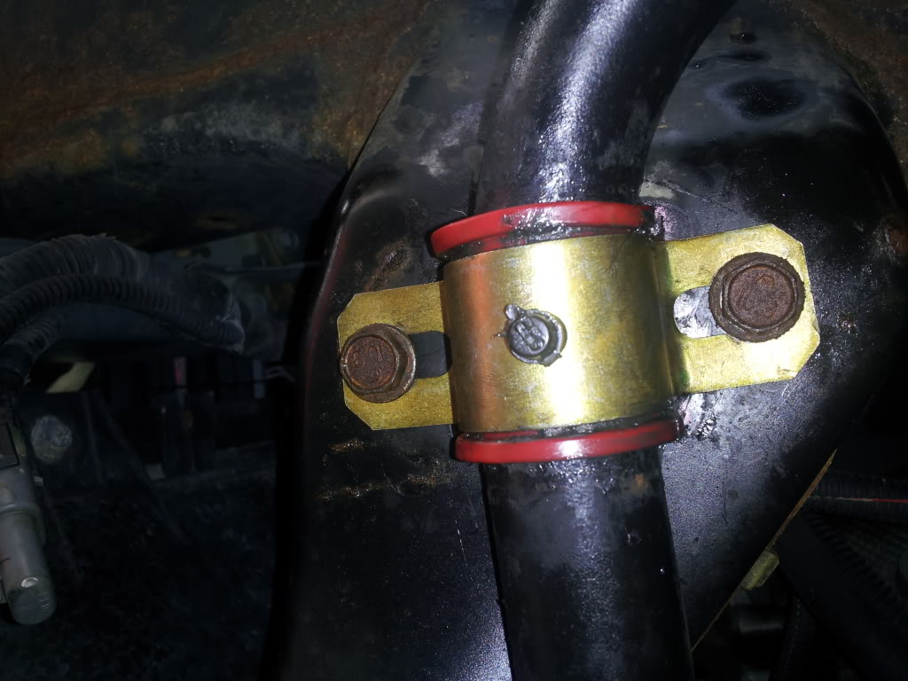

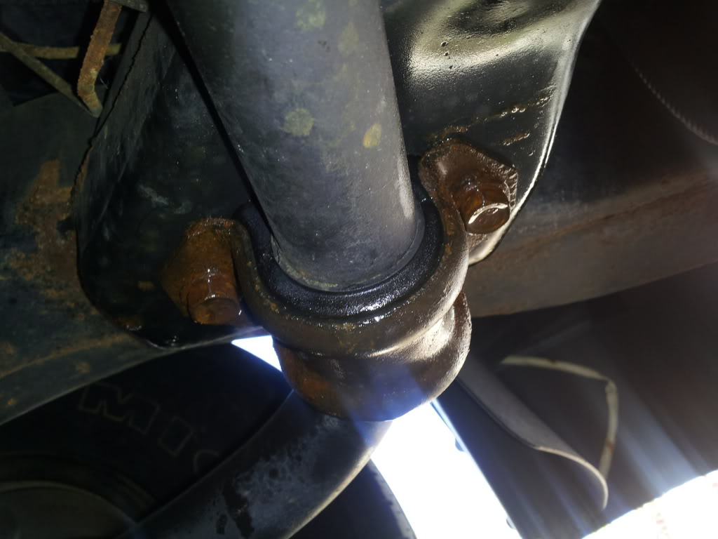

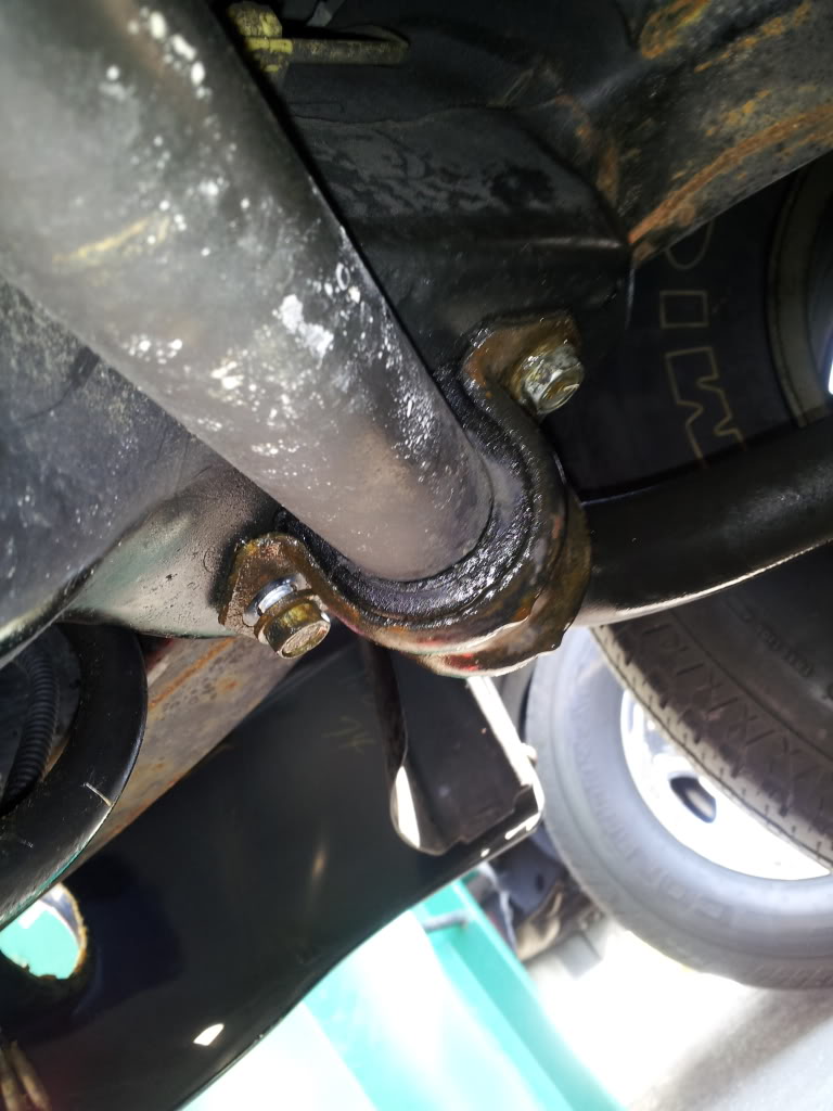

i also forgot to mention that both sway bar bushing brackets come off with a 15mm socket and i used a 1/2 in ratchet
