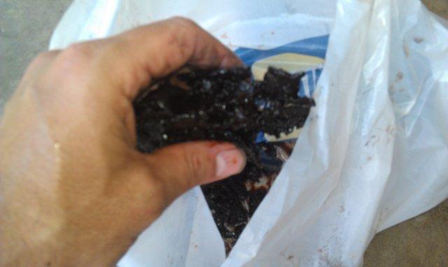

ok, I used the seafoam trans tune last night with a couple of oil changes. I just pulled the pan down and I noticed a crap ton of GOOOEY stuff on the bottom of the pan.. Im wondering if it is normal to see alot of this GOOEY residue on the bottom of the pan. I had to use a roof scrapper to get it off. I have included some pics...
I have a funny feeling that you may say that it is something else besides years of gunk built up in the trans...
Should I just stop now or continue the install of the TCC Solenoid and chance that it was just gunk from the trans tune.. Dont wanna waste a 100 dollar part if I need to buy used/rebuild this joker.
