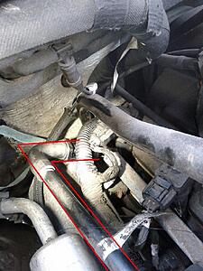

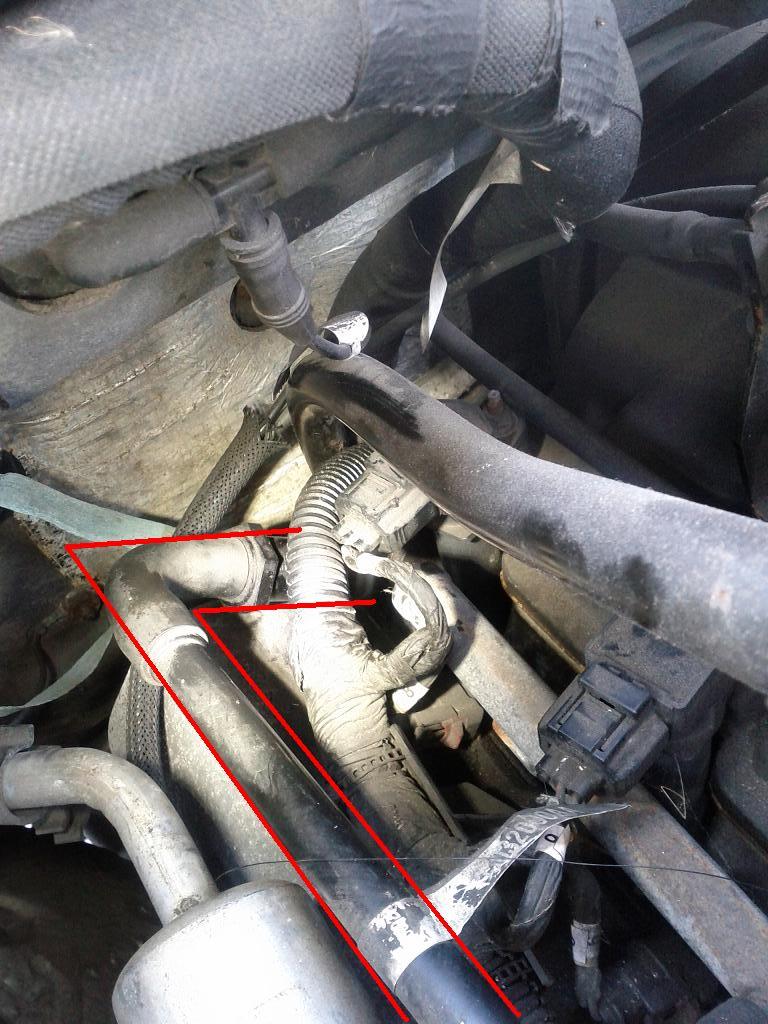

When it starts it wont stay at idle and dies. But if I give it gas it will rev and drive fine.
While looking in engine bay I noticed what looked to be the pvc pipe broke off from motor. Do you know what part this is? The black plastic tube leads to the left rear part of the valve cover.

That looks to be an AC or Coolant line. The insulation is a tell-sign.

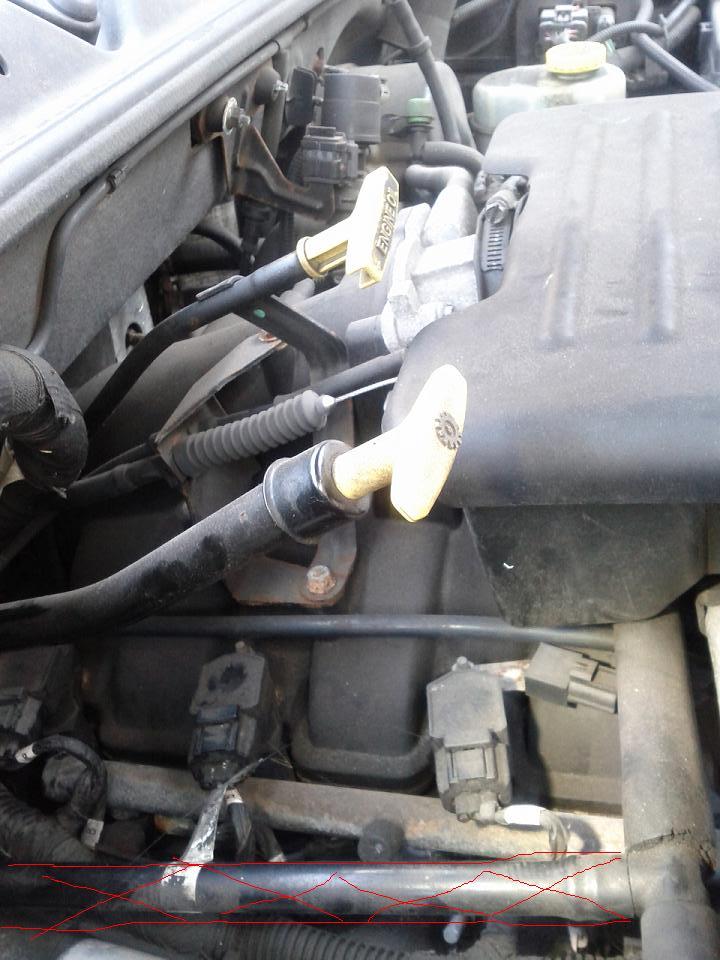

you are wrong indy, it is a breather line of some sort, from that pictured T connector it goes across the engine underneath the Airbox and into the top of the engine on the driver side near the back, it goes to the factory air filter box (after the filter) and it goes into the top of the engine on the passenger side

I may be wrong. Your probably right. Cant tell from the photos and doesn't look like anything I have that I can recall (all my stock crap has been replaced years ago.)

That is the breather tube for the pvc system on a 4.7 eng.
PS. If its cracked I'm not sure it will cause a bad running engine it just allows fresh air into the crank case. I would repair it to keep dirt from entering the engine.

If it is pcv it is to allow blowby to go back through the intake, not for fresh air. It is an emissions item that prevents unburned fuel from being vented to the atmosphere.
Repair that line first. I'm not able to tell from the pictures what it is.

The photos are for the breather lines going into the crank case. The PVC is located in the oil filler tube with one line going to the intake.
