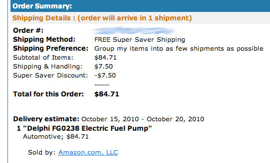

Delphi. Just replace the whole thing correctly and be done with it. Fuel isn't something you want to mess aground with.
I got the whole thing, brand new, for $85 on Amazon 10/10/2010.
Delphi FG0238
HTH,
IndyDurango
