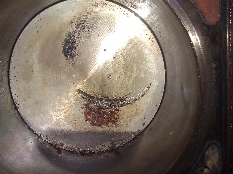

Ok I got the heads off. Seems it dropped a seat.
But there is also a slight impact depression in the piston.
I have not read on this on any of the posts.
Can I ignore it?
Should I grind it smooth?
Can it be filled?
Any ideas?

it would help if you put a pic up so we can see the damage

Here it is:

thanks for the pic it doesn't look that bad i would run it
