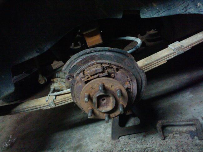

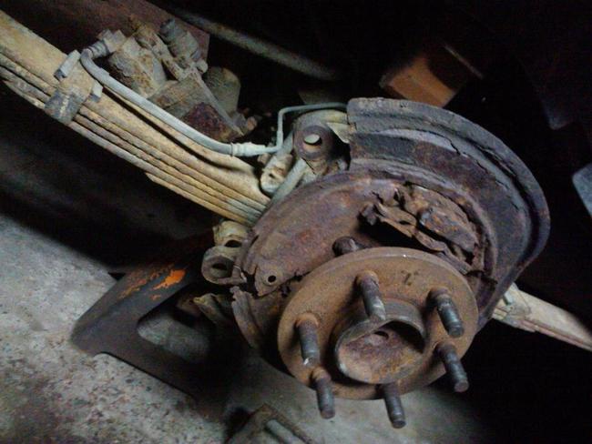

I don't have the plate on the rear drivers side at all. This is the condition of the plate on the passenger side.

I've called dealers all across Canada, and all across the states. No one has any backing plates. So I called Crysler.
Crysler tells me 39 will be released on Nov. 2, 2012. Unfortunately they don't know where they will be released too, and even worse I'm No. 50 on the dealers list of hopefuls.
I'm not excactly sure where to go from here.
The part No. is 52010420AD, or so I'm told. It's the entire assembly because I'm told I can't buy just the plate.
Any insight to what I can do to get my Durango on the road would be greatly appreciated.

Using the part number you supplied:
Factorymoparparts.com
$114.70
http://www.factorymoparparts.com/52010420ad.html
Also allmoparparts.com
$106.92
https://www.allmoparparts.com/oempar...num=52010420AD

another option could be a scrap yard or find someone online parting their durango
Old Sep 21, 2012 | 02:06 AM
krupaeric's Avatar
krupaeric
Joined: Apr 2012
Posts: 289
From: Silvercreek NY
if the part is that unavailable, you might have to try to buy the disc brake conversion kit. yes its a little on the exspensive side. like $1,200. but they will be brand new. and taking the axle apart is a little tricky but not impossible. most ppl with mechanical apttitude can do it. so if it means letting your d sit for months and months it may be worth getting the kit.
