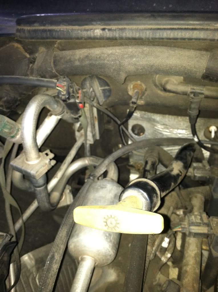

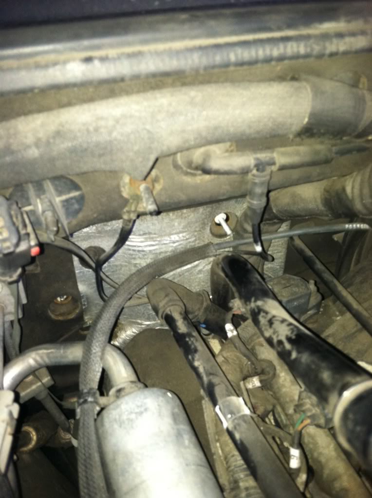

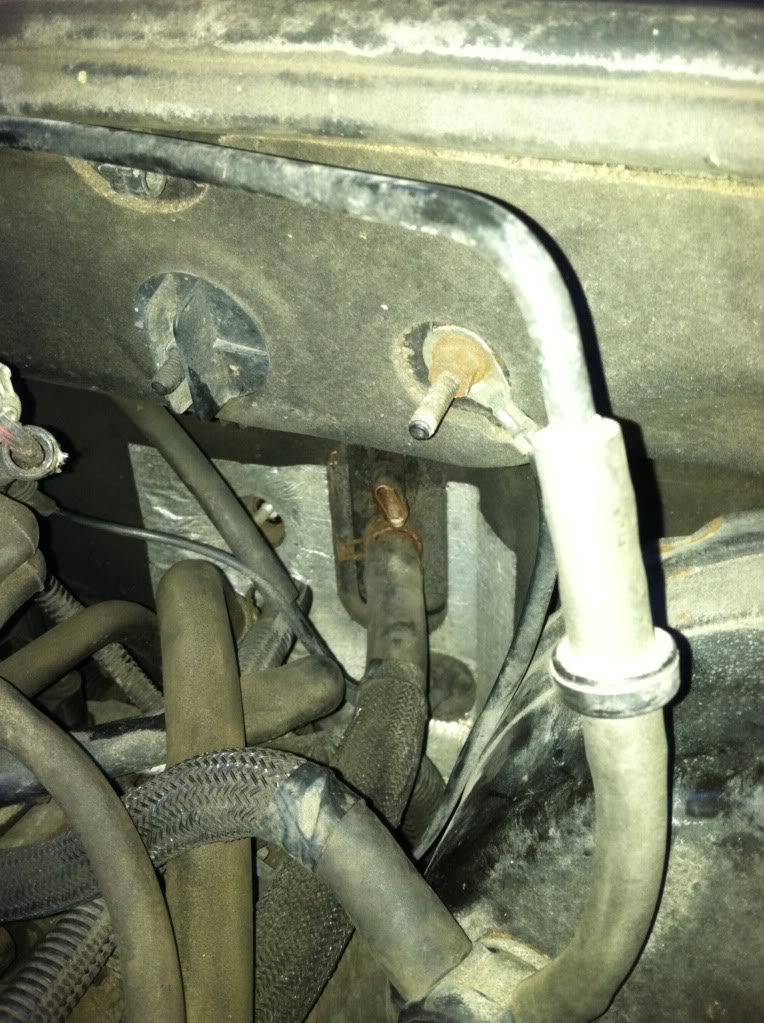

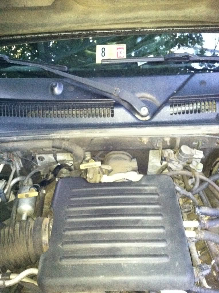

Hey guys, I've got a '00 durango and am in the process of replacing the heater core. Ive already got the dash out, but I'm having trouble removing the HVAC. From the research I've done, it seems to be held onto the firewall by 4 bolts. I've located and removed 3, and am having trouble finding the last one. Are they all where the silver squares are? Thats were the 3 I removed were. In my searching, most threads that had pics were old and the pics were no longer there, just nice red X's.
I snapped a couple quick pics of the areas on the firewall, and if someone who has completed this project before, or anybody who know where they are, if you could circle them on the pics that would be much appreciated! Like I said, I've removed 3 but cant find the last one. thanks guys

Remove the PCM. There are two bolts/nuts behind it. You are also going to need to remove the A/C lines too.
