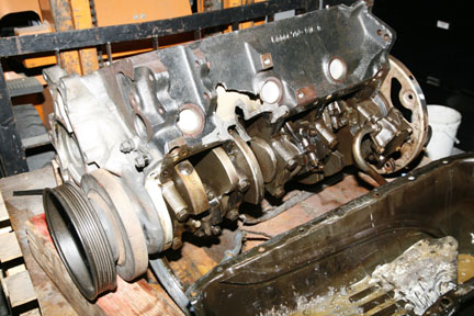

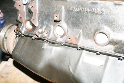

Finally, I have removed my engine after following recommendation of this forum. Please see attached photos
Attached Thumbnails 1998 dodge durango 5.2l-20121111_1106a.jpg   1998 dodge durango 5.2l-20121111_1100a.jpg   1998 dodge durango 5.2l-20121111_1103a.jpg   1998 dodge durango 5.2l-20121111_1113a.jpg
