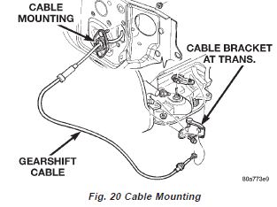

Do u happen to know if there is a diagram of that? The chilton isn't much help.
Here is the 2002 Factory Service Manual ~~> http://www.mediafire.com/?2cg2hgim2zz

The part that locks onto the tranny doesnt. Fit through the plate hole. We have to make the plate hole bigger.

That's probably the problem. The jacket needs to attach to the bracket at the transmission and at the firewall for it to work properly.
