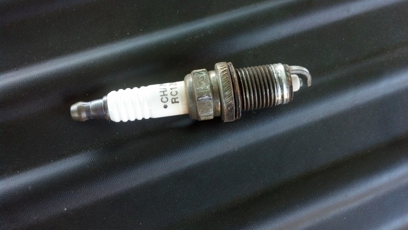

Well Here Is an Update on this Durango I got Last wednesday I have Only Had this one week as of today.
Not Knowing what type on maintenace the person did on this Durango I went ahead and Put new NGK Plugs in the Durango.
Look what I found On #6 Plug
I tried to get the Spark Plug out and it was so tight i had to use a braker bar to get it out felt like someone before me had cross threaded it and just kept going and didnt care well I got it out and I used a Save a Thread Insert.
I know their not the greatest but it works for now I can Heli coil it when i Need to Change the Plug in 50,000 Miles. or more.
I re threaded the hole with the save a thread tool they Gave me and then I took a Vacume with a small hose and vacumed everything out of the cyclender.
was a tough Job but not my fault someone else screwed it up.

i have only one question for you? how do you inted to get 50k miles out of copper core plugs?? and if you put anything besides copper core plugs into it expect to have problems caused by them shortly
I Just Inteneded To Use the Plugs That the dealer and the Book tell me to put in their and my mechanic also told me to Put NGK he said they should Last longer than Champion Spark Plugs.
