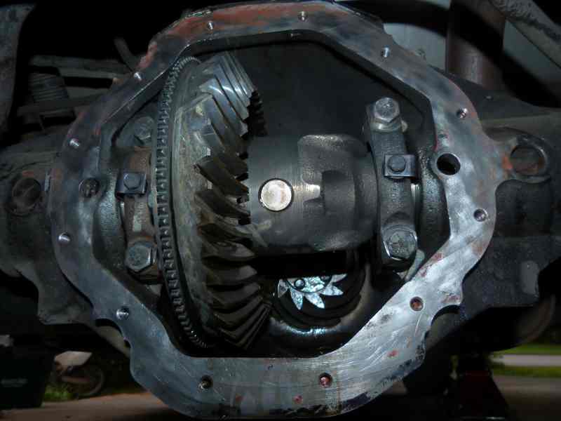

I've taken the cover off, PITA as there was no gasket just the tube crap. There were only a couple very small pieces of metal on the magnet, smaller than a McDonalds burger bone shard.

Should an open look like the mine? It looks like a LSD from the pics I've seen, haven't seen a pic of an open.

IIRC, there are clutches in the carrier but, unless you are seeing chunks in the old oil i would not worry about them, chances are they are fine... looking at your PIC it looks like my open diff from the best i can tell...
