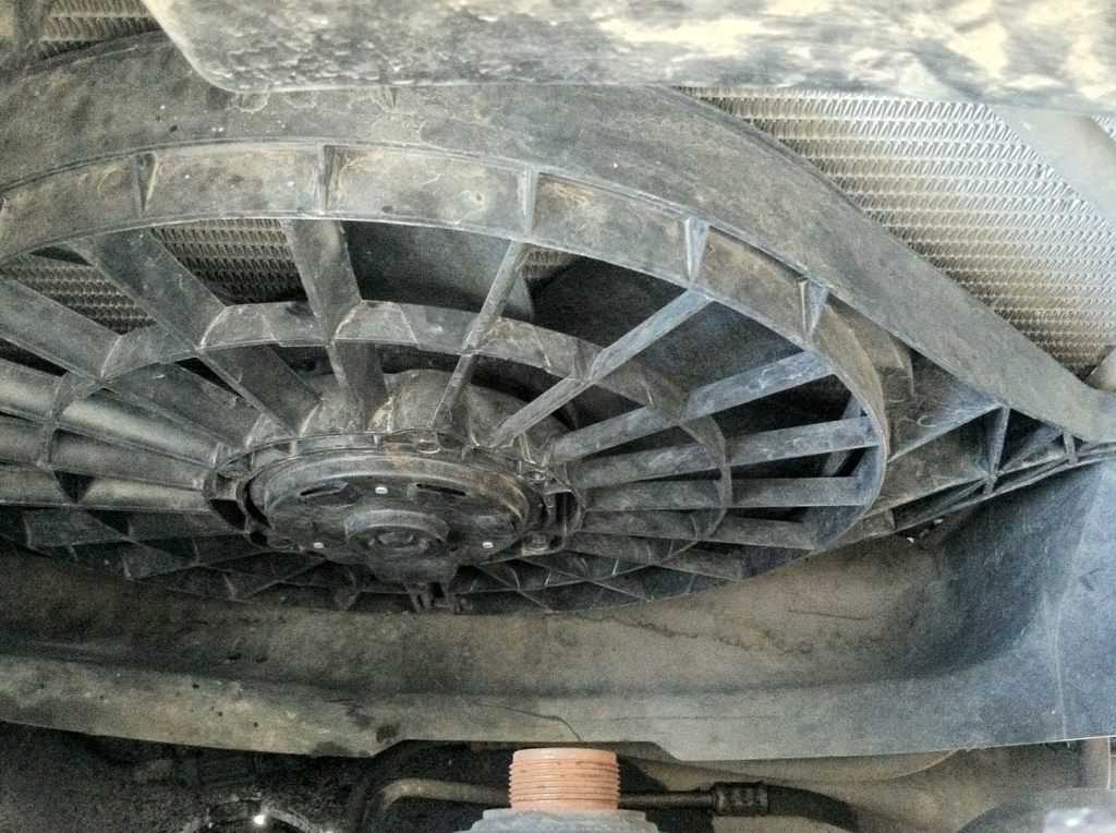

In TX I just ran the factory efan (clutch fan removed).

Some say it's enough and some say it's not, but I have no experience with that since they didn't add it until 2000 and mine never had the TSB that added it done.
