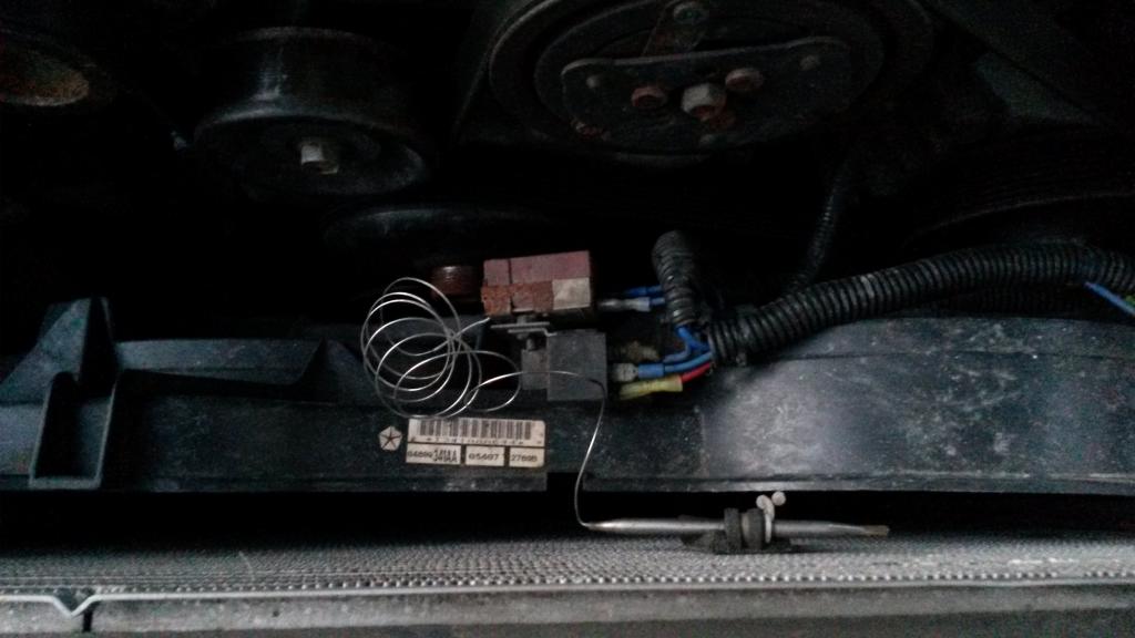

I think that rod on the radiator senses when to kick the fan on but my radiator doesnt get hot

the aftermarket sensor uses the radiator temperature to turn the fan on and off, however if the radiator isnt getting hot it is either a blocked radiator or a sticky thermostat that isnt opening far enough or at all.

Yup, that probe probably isn't getting hot. Most of those probes that I've seen are actually pushed into the radiator, but who knows since it's an aftermarket setup. That's why when I did my electric fan swap I went with a sensor in the upper hose.

Ya, I can't say I've ever seen this setup before. I also don't see this being as effective as a engine based sensor.
But with that all being said, I'd go with what shrp said. Probably your best bet
