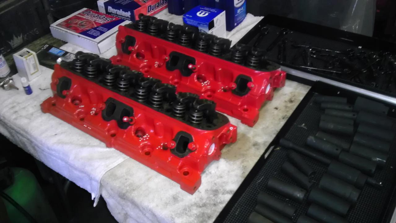

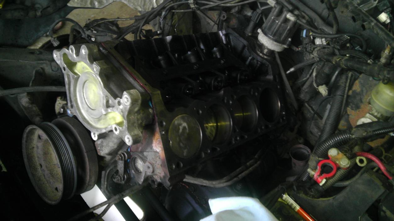

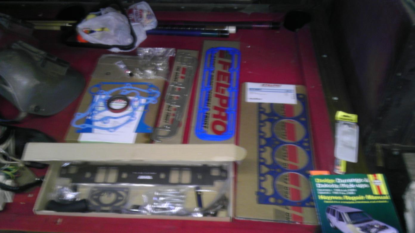

I also rebuilt the torque end of the d. Replaced the cylinder heads with a set of iron ram heads and painted most of it. And yes every thing was 're flashed.
