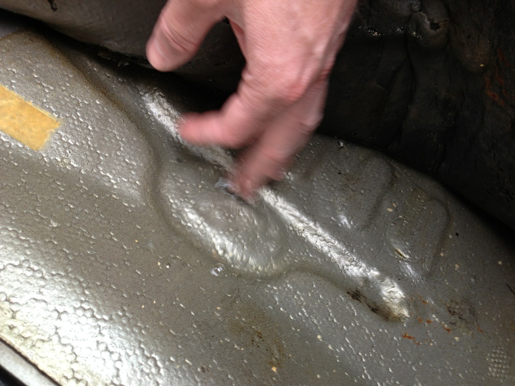

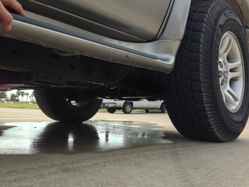

I had the same issue. After heavy rain..
I simply drilled a hole and placed a rubber mat under the carpet so the water would run under the rubber mat to the lowest point where the hole is and drip out. I never cared to find the source of the inlet....

Brilliant idea. Anyway you could identify the location of your hole in the pics. I have looked and think I know but I am not sure. Why recreate the wheel if you have a spot that works.

I didnt care to fix it. But I'm all ears to see where it's coming from
