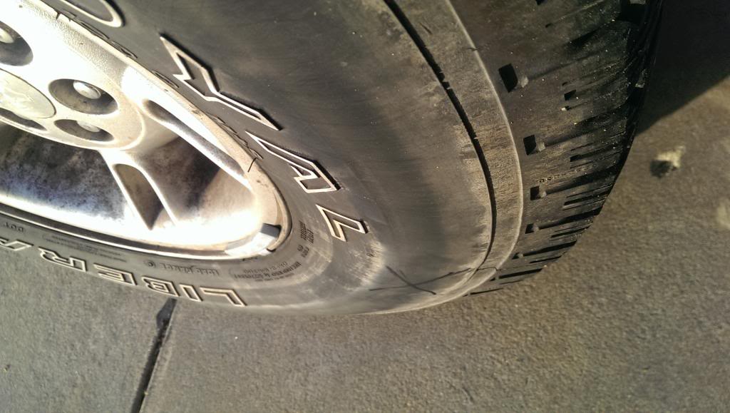

So while washing the durango this weekened I noticed a bubble on the side wall of the drivers tire. I took it to walmart to find out they no longer carry those type of tires. They asked if it would be ok to but on a single firestone. I told them no as I did not want the tires to be mismatched. I call up uniroyal who is having me go to a certified shop to have the tire inspected. After that they will figure out what to do. Here is a pic, very hard to see the bump but you can feel it with your hand.
