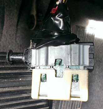

What's the trick to disconnecting the wire harness from the brake light switch on a '98 Durango?

Most of the connectors have a double lock. A tricky little red or yellow plastic thing has to be unlatched and slid out of the way to allow the main lock to be pressed.

Thanks for the response, but your description doesn't match my connection. I attached a picture of it. I tried pressing in on the green tabs, but no luck. What am I missing?
Rather than pressing in have you tried prying up the green tab in the center. It may be a lock down connection once you reconnect the harness to the switch.

Tried, no luck.

It is a quarter turn then pull up on the older Durangos, not sure on 2001-2003 but I think it's the same.

Update...turns out there isn't a trick at all. It should have just easily pulled out. The connecters had welded together and I was fighting a lost cause. I had to cut the old wire harness off and splice in a new one (kit from dealer). Installed new switch and everything is working fine. Thanks for all the suggestions.
