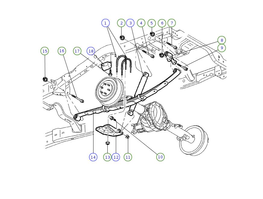

I do understand the dislike of Torx bolts in a location like that, Ford/Mercury used a shallow Torx on the 1999+ Cougars for the rear caliper bracket bolts, nearly lost a thumb due to one of those.
As for not finding a picture, best I can do is the catalog illustration, if it's a '99 Durango and you're looking for #16 in this picture then the part number I posted should be correct.

Yup, number 16 is the one I'm having issues with and I suspect the shackle bolts (numbers 7 and 9 on the diagram) aren't going to be any different.

It's just a bolt, all three of them.
