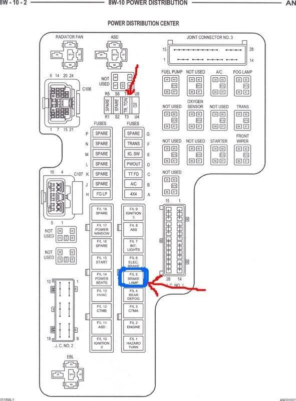

I did take it back. But realize these guys are not the brightest. One of the underlings came out and diddled in interior fuse box on the drivers side. He tried checking all the fuses but nothing was bad. Then he hooked up another checker that was connected directly to the battery cables and they still tested good. But it did something that gave me wipers and the washer, but no sunroof. When I ask him what was going to be done about it he told me not to worry about it until spring--like I said, not the brightest. I gave up and left with atleast wipers. The next night I noticed the sunroof panel had power (lit up). I tried it and it was working--yay! However, now my wipers and washer have stopped again--boo. I've been looking for the diagram for the box under the hood--previous owner decided it would be more fun if it were a guessing/matching game and tossed the cover. If anyone knows whr a copy is plz message me or stick it on here. Ty.

I believe this is what you are looking for....

This one should be close to yours:
Originally Posted by hydrashocker
This should be a closer fit, but there are a few different ones.
That... is exactly what I was looking for! The first diagram was all I could find searching online. You sir, are awesome.
