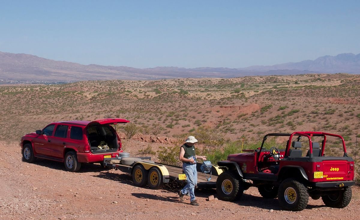

Exactly in the middle of New Mexico. These two (three) have been tagging along with each other for 14 years. Trailer+Jeep weight is about 5600 lbs. When I moved from Poughkeepsie, NY to Albuquerque, NM in 2011, I towed the setup 2041 miles with the Jeep hard top on and it full of personal things. I'd guess it weighed more like 6400 lbs then. Tow rating for my D is 7300. [Same PR4 paint code on '93 Jeep and '01 D.]
I should say, when I did that cross country ride, the D had maybe 90,000 miles on it. A year+ after the trek, and more towing the setup at 9,000 feet in CO, the trans died. I had it rebuilt with high end torque converter and kevlar bands and it's better than new now.
