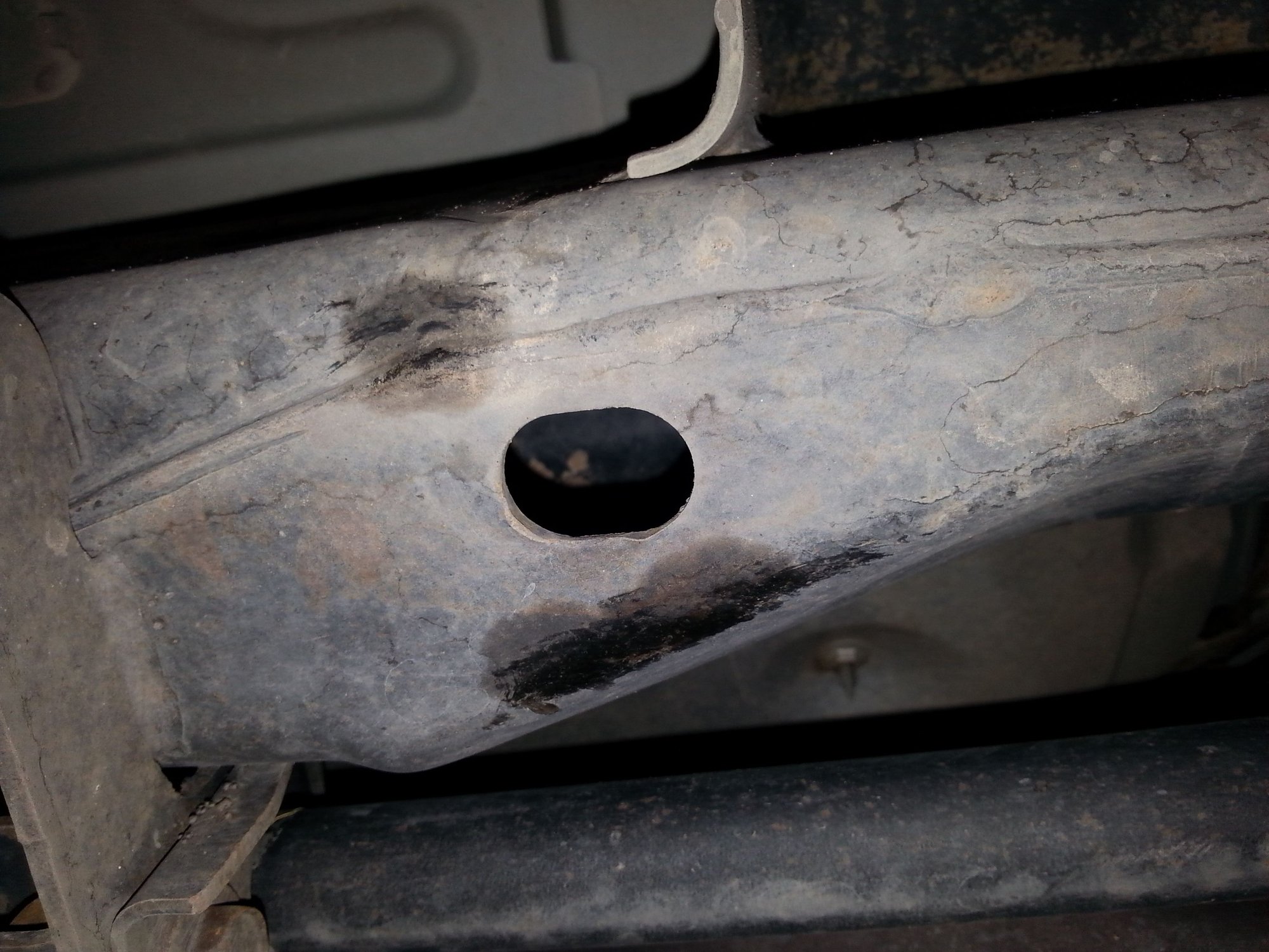

dumber question time.
I've not owned anything other than a car so not sure where to put the floor jack underneath I have taken a couple pictures of what I think might be correct any help is appreciated
thanks
over this hole?
inside this area?
