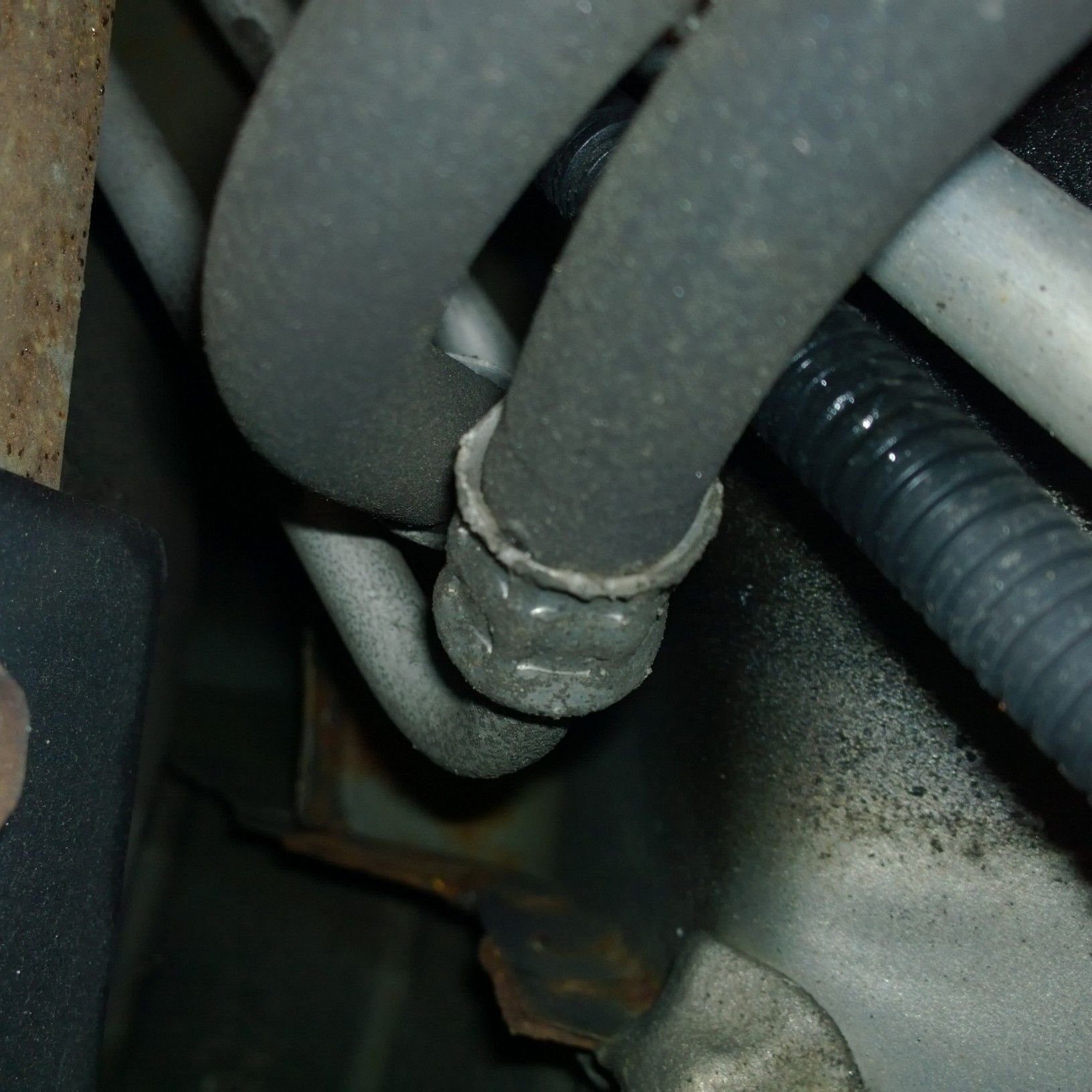

I have a coolant leak that happens for a few mins. after I turn off the car. It does not drip constantly but for maybe 20 mins after. It's dripping at the pax wheel well from 3 lines coming down then over (rear climate control areas?) at some connection points (see pic). Slow steady drip.
Heat is good in front but cold in rear cabin and back.
What's the name of these lines and connection and what is the fix? Seems i need to remove the wheel and liner.

Those aluminum lines look more like ac lines to me. I think I can see a coolant hose next to the aluminum lines though.

those appear to be the lines for the rear hvac unit, they should go from a small electric pump on or near the firewall to the rear heater core/ac condensor, im not sure if they are one piece or multiple to make the run from front to back.

This makes sense. No heat in rear cabin so perhaps need a new heater core also. The lines are metal and run all along the pax side of the truck to the back, past the rear wheel. That area looks like it need some work as well (2 pics attached). Also the connection looks similar in the 2nd pic.
Digging for a service manual. I have an '03 Daktoa for now but not cutting it for the HVAC, rear cabin stuff. I just need some guidance on how to fix this.
ac lines ending at rear near pax wheel
rear ac line connection, similar to front where leak is

I think i found the parts - Mopar Part 5069004AA A/C LINE REPAIR COUPLING 02 and 03. I think I only have one leak and 2 lines are heat and one AC or return.

So is that an A/C line or a heater line that has the drips coming from it? The a/c system isn't going to be leaking liquid like that. Even though some parts of the a/c system have liquid refrigerant in them, it is a gas under normal atmospheric conditions, so if there is liquid on the a/c lines it most likely came from somewhere else.
And yes if you are planning to work on the a/c system you need to have it evacuated, then when you're done you need to replace the dryer, have it put under vacuum, and recharged.

Assume it's a heater line, just trying to sort the line size as I see some parts here - http://autorepairdomestic.com/products/query/Mopar%20Part%205069004AA%20A,SL,C%20LINE%20REPAIR% 20COUPLING/
I'll take another look but from the pic it looks like the largest heat line so the 5/8 coupler. I can't find any details on the 3 lines as they are sold in a kit.

Don't assume. Borrow a radiator pressure test kit, pump up the system and find the leak when it's cool and safer. You can also pull the rubber/plastic flex panel behind the pass tire on the inner wheel well for a beeter view of those down tubes to the rear.
