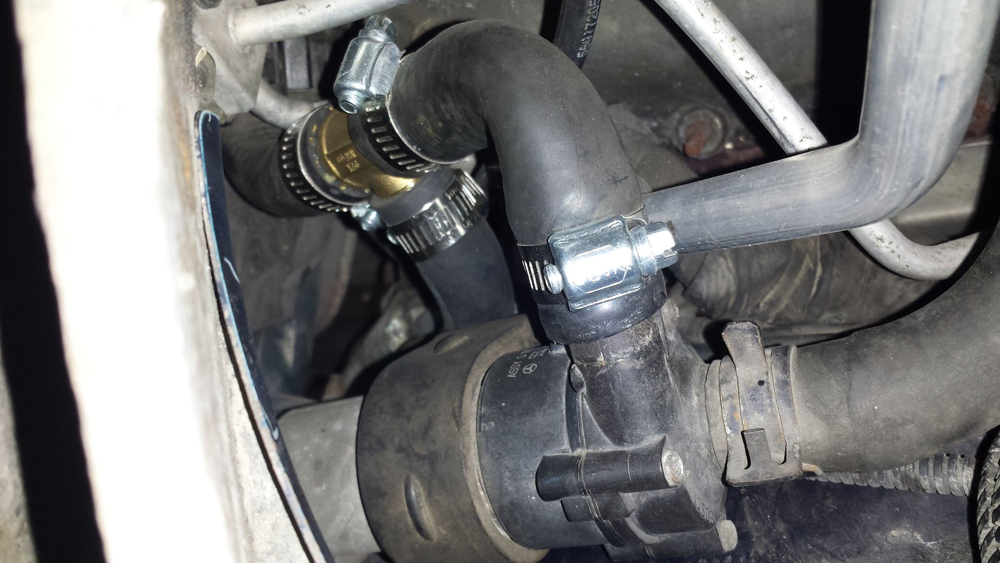

Remove the worm clamp from the hose where it connects to the black plastic and replace it with a constant pressure clamp. The plastic will go through heat expansions and the clamp won't give, causing the plastic to eventually crack. This is especially the case for plastic radiator end cap fittings.
