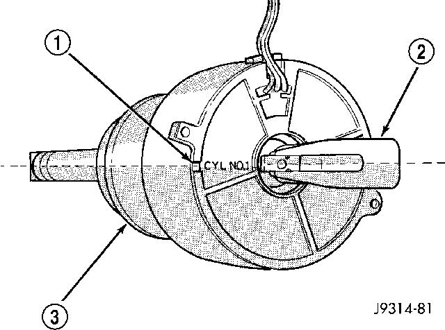

Position the distributor like this at TDC (#1 cylinder) of the compression stroke. This will be fairly accurate but to get it exact you need a scan tool.
