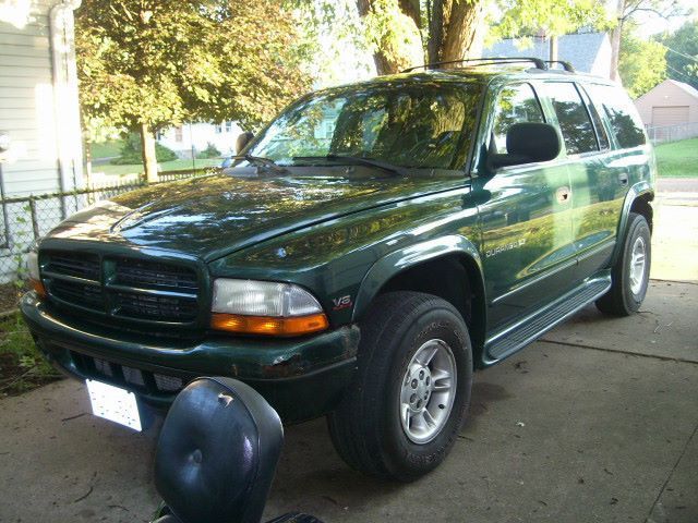

Hey guys,
Is there anything I should know before I make a major purchase of a 30ft trailer to pull behind my Baby? Is it a good idea? Any tips or changes that I need to make to her first? Everything on her is factory, with exception of a new brake line & a few sensors I've had to replace. She has roughly 145000 miles on her. ♥ Thank you in advance.

Not sure what you mean about a badge, but my engine says V8 4.7L. so... lol
Yes, a camper is what I want to pull. But I read that around 6000-6500 gross weight is all I can pull legally. (or there about) So I have to look at smaller ones. Also asking because I know I'm not alone in pulling campers with a Durango. Hoping to get ideas as to the cost I will be facing.

Looks like you have the exact same D-Rex as mine (2000, 4.7L V8 Magnum, 4x4, etc...). I've heard a couple of different figures, but I think ours can tow around 4500 lbs. 6000 sounds like an overload.
