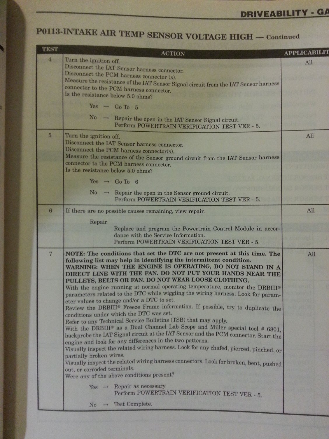

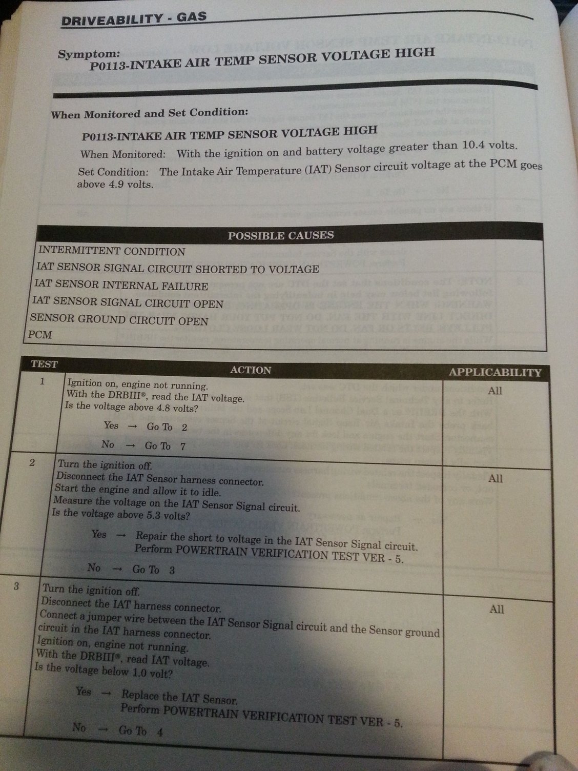

Hi, I have a Dodge Durango 2000 4.7L 4/4. Initially my problem was my car would turn off when idle, it will turn on every time as long as you press the accelerator, as soon as you take your foot off boom it would turn off. So I read other posts where it would be the TPS and or the IAC sensor/motor (right under the TPS sensor). I had replaced the TPS sensor a few years ago but it wasn't a dealer part it was from autozone. I had cam shaft and crankshaft sensors from there that I had to replace with dealer ones due to recurring issues so I'm doing dealer sensors from now on. But after replacing both TPS and IAC I now have a P0113 code. Could it be a bad IAC sensor? Or is there something that has to be calibrated? The initial problem has been fixed but now this code.

Sorry I have had issues with camera. I think they are finally clear now.

Cool thanks for the quick response! I'll try to troubleshoot with these techniques. Is that book a work Manual?

it is yes, a factory manual. It is for a 2002 Ram 1500 but I am sure it will work just fine for your application.
