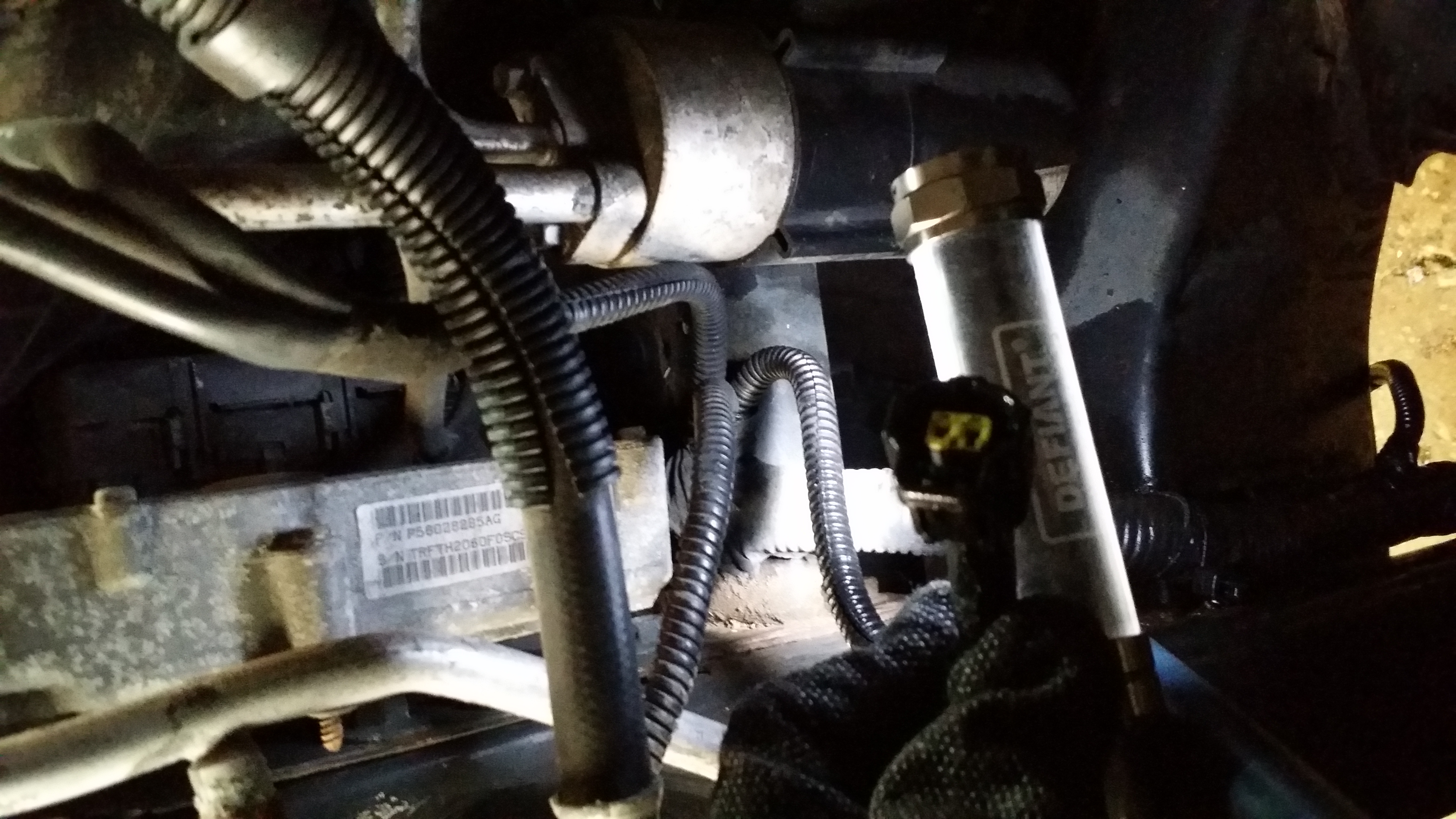

I just got finished replacing basically the whole cooling system and noticed that the speedo is stuck all the over at 120. Car on or off.
I did notice a plug just hanging and not connected to anything. Kind of hard to see, but it comes off a group of cables that also contain the 3 connections on the left side(looking at the truck) of the windshield fluid reservoir.
Anyone know what this is and if it had something to do with my speedo?

Was it connected before?

That's the thing...I'm not sure. I just know I didn't purposely disconnect it.
That's why I didn't really think about it until I noticed the speedo
