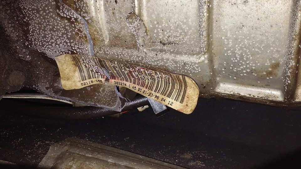

Hi I have 1998 dodge Durango slt 5.2L 4x4. The transmission extension housing is cracked all the way around it. It was caused by the drive shaft universal joint coming off and hitting the ground. It has a part# on it 19104A My question is. I found one but the number on it says 19104AF will It work for my transmission?

The two letters at the end of Chrysler part numbers only indicate the manufacturer of the part. If the numeric parts match it should work. You should have a 44RE transmission, so if the part came out of another 44RE transmission it should fit.
