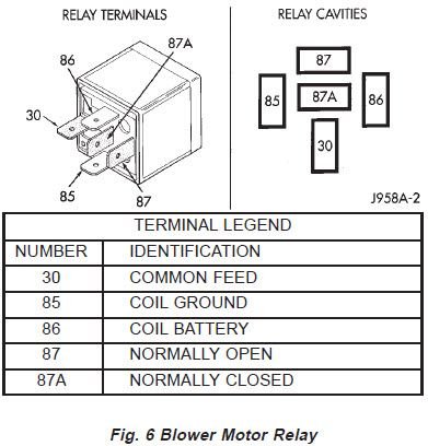

OK, checked the #7 fuse at the left end of the dash, it has power and the fuse is good.
Which relay should I pull?
I pulled the relay behind the glove box and only have power to the #86 pin when the ignition is turned on.
Not sure which pin should be hot all the time, but none are.
