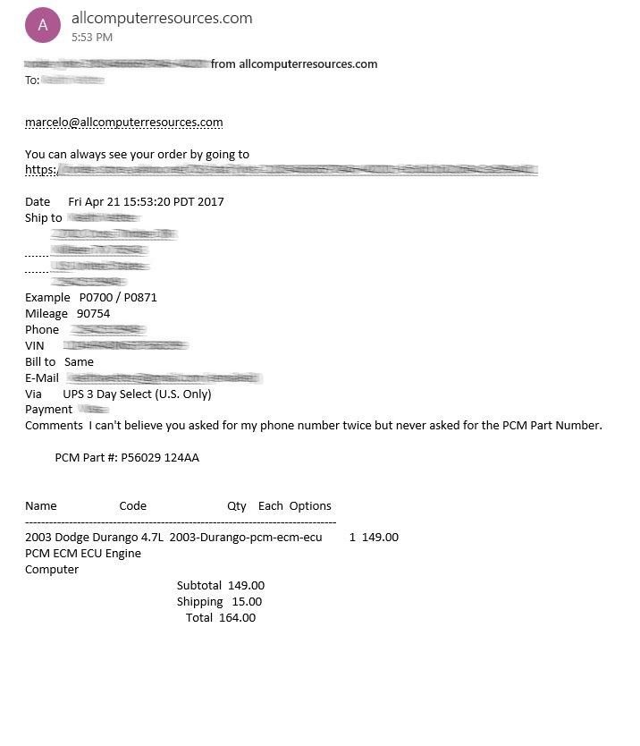

I fix helicopters for a living. After calling around and talking to a few other transmission mechanics. I asked one, if the PCM could be causing the issues. He said it absolutely could. He told me that a customer came to him about a year ago and asked him to replace the tranny. he was having similar issues. The transmission was replaced and the issues remained. It ended up being the PCM. Being that $164 is much cheaper than a tranny and I felt all along it wasn't a mechanical issues. I decided to go for the pcm. If it didn't work, it was only 164 extra. I figured if I paid for the tranny after already paying over $900 for the valve body and it ended up being the computer, I would really be pissed off.
So I found allcomuterresourses.com and found my pcm there. It is re-manufactured and comes with a life time warranty. Provided my vin and mileage for the flash and received it within a week. Transmission works perfectly and engine light hasn't come back on. The computer, flash and shipping came out to $164.
My only regret is having to pay Dodge +$900 to not fix the issue.
