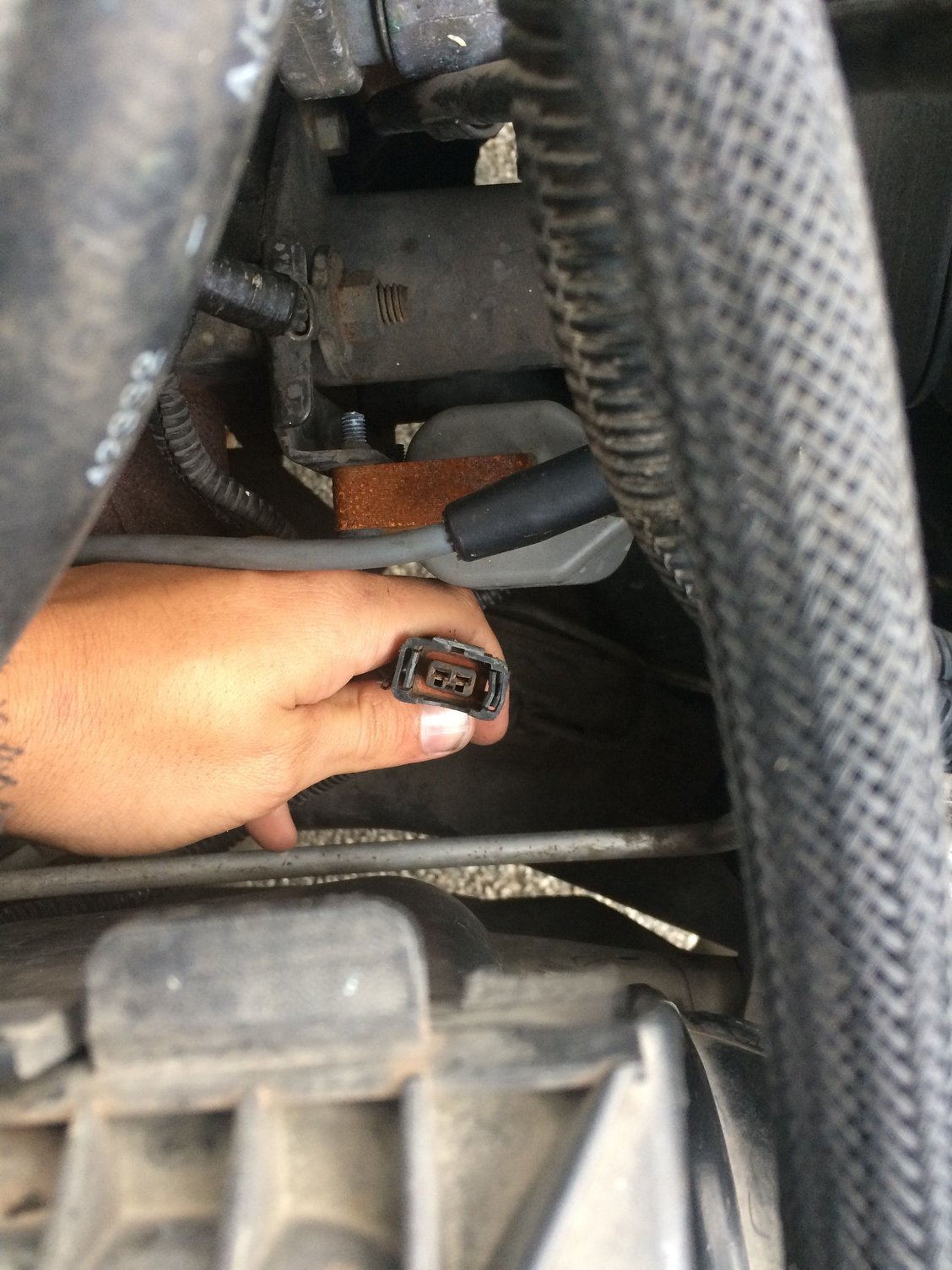

uppon further inspection I also found this electric connector
since it is always so hot here I want to jump the electric rad fan to always be on where would be a good spot to run a 12v+ to it
