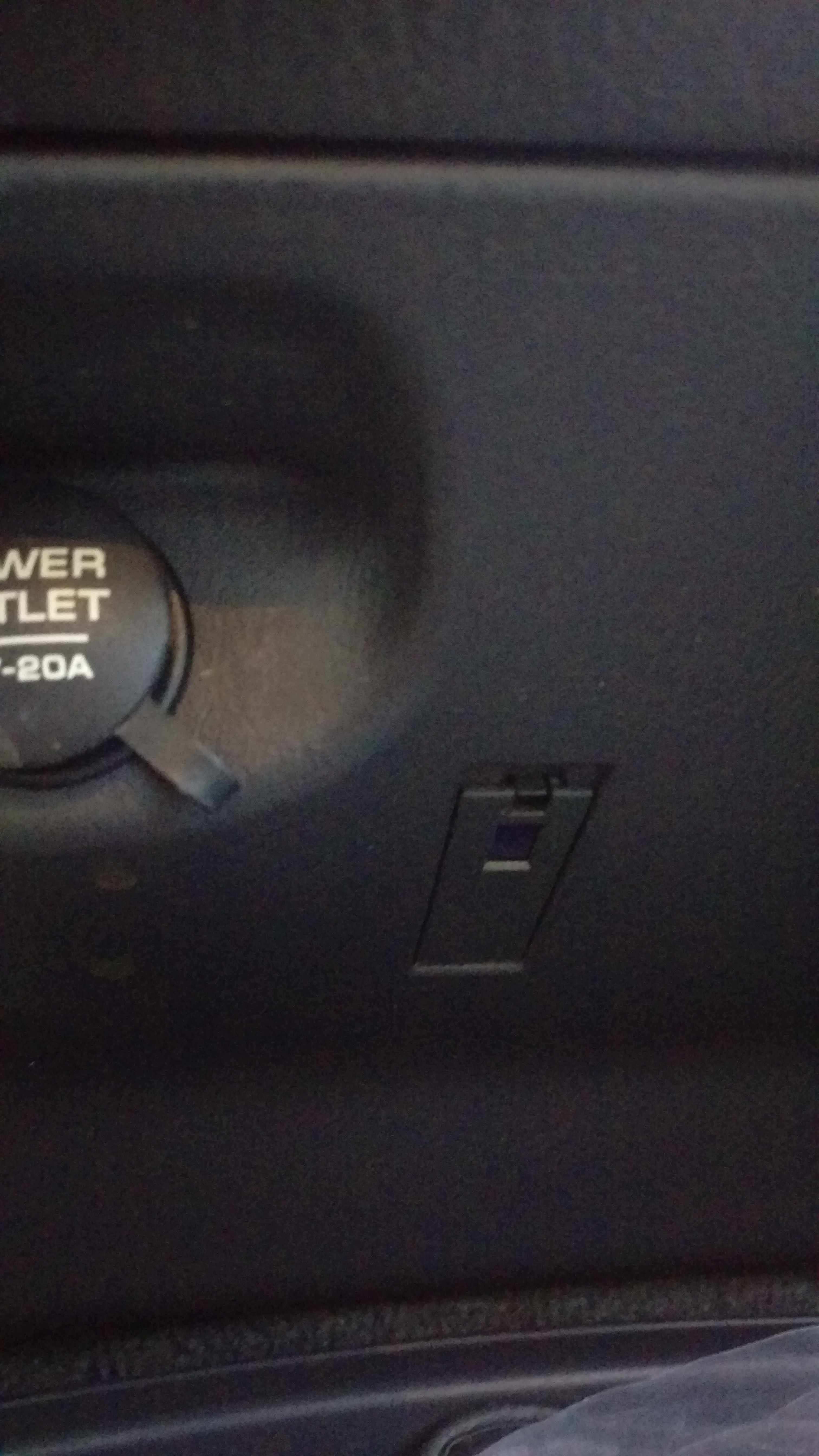

Hi all,
Wondering if anyone with a 2001 R/T had any idea what the sense on the right side of the cigarette lighter was? It looks like a motion sensor for the alarm or some sort of IR blaster?
Attached Thumbnails 2001 Durango R/T Owners - Anyone Know What This Sensor Inside Is?-tmp_12546-imag12851914477452.jpg

Looks like a light.

The FSM refers to that as a 'lower bezel console lamp', but I have no idea how to turn it on. I've never noticed it before and I bought my R/T new.

Yes. It is an "ambient light" comes on with the headlights. My Dakota had one too. Barely noticeable.

Very interesting thanks guys! I couldn't find this in the FSM.
The 2000 Durango doesn't have this. I just stumbled on it and was puzzled. I'll check to see if it comes on with the headlights at night.

I found it in the section on how to remove that panel, what to unplug.
