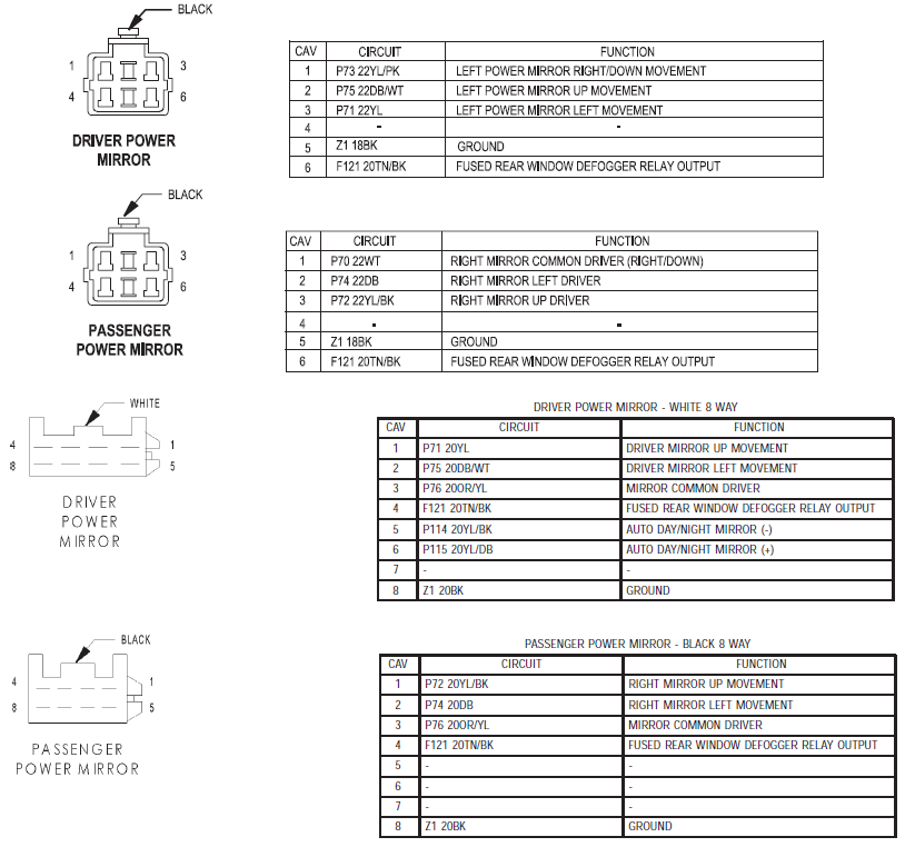

The 98-00 and 01-03 smaller "sport" mirrors look the same, but have different electrical connectors.
Now you say the mirrors are heated, but those would have 5 wires for the heated ones. Here are the mirror pinouts. Top is 98-00 and bottom is 01-03.
Old May 11, 2017 | 02:14 AM
Gascreek's Avatar
Gascreek
Joined: Feb 2014
Posts: 4
My bad, had another look, and yes there is 5 wires.
