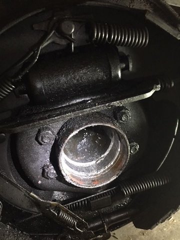

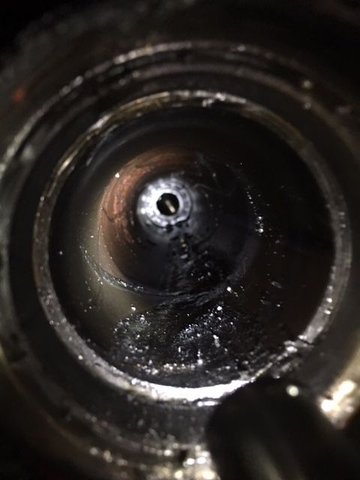

Spot on, had only thought about the slide hammer to get the bearing out. Luckily, I didn’t need it, I finally got that sucker out! I’ll attach some pictures once I get to my PC of the aftermath to show what kind of shape it was really in, and you might understand why it was such a chore, and maybe give someone else an idea that has this issue what their issue might be

Talking Pics
What wheel bearings do y'all suggest? I found some National ones but it also says they do not require a seal. Input?
