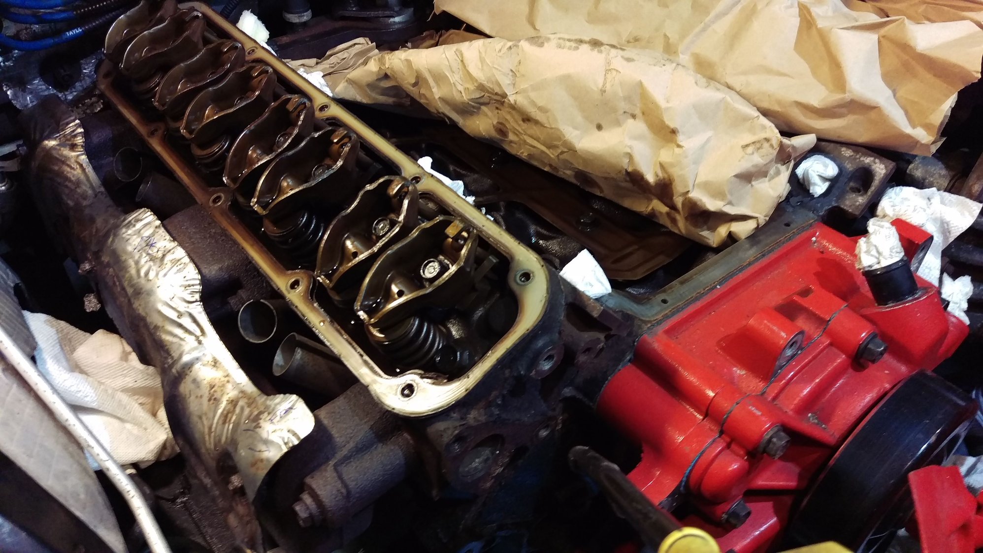

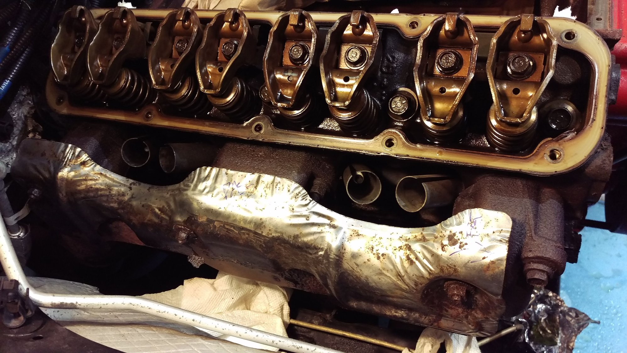

Hi all, brief recap, over the winter did the water pump on my 5.9. Then discovered the plenum oil leak after noticing oil was burning. Did the plenum, timing chain, plugs, rotor etc. Then was getting pinging under load. Figured it was the iridium plugs after reading the forums. Got stock plugs 1 degree colder then went in to check the cylinders and saw a bit of coolant in the the 7 and 8 cylinders. So Head gasket is leaking. Now I am at the third major repair on the truck and upto the heads. Never done heads.
Here are some photos. Does anyone have any advice on things to be aware of when I go to remove the heads? First I have to see if the intake bolts will come off (hopefully not break). Then I have to remove the bolts holding the rockers in place and put them in a cardboard in the same order. Then I need to pull out the pushrods and again keep them in same order. Then I need to take the head bolts off and pull the heads off right?
Any tips and or snag points anyone would like to mention?
