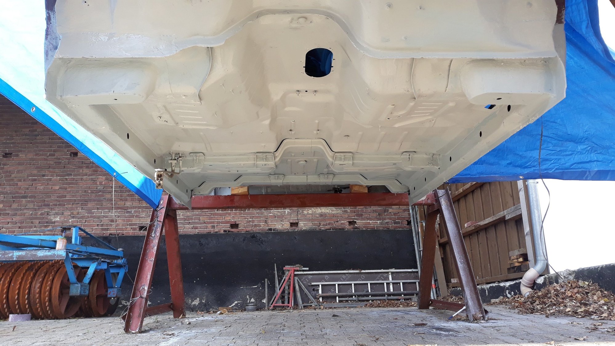

this is rust background
underbody protection is still missing, come tomorrow

here more pictures than video
