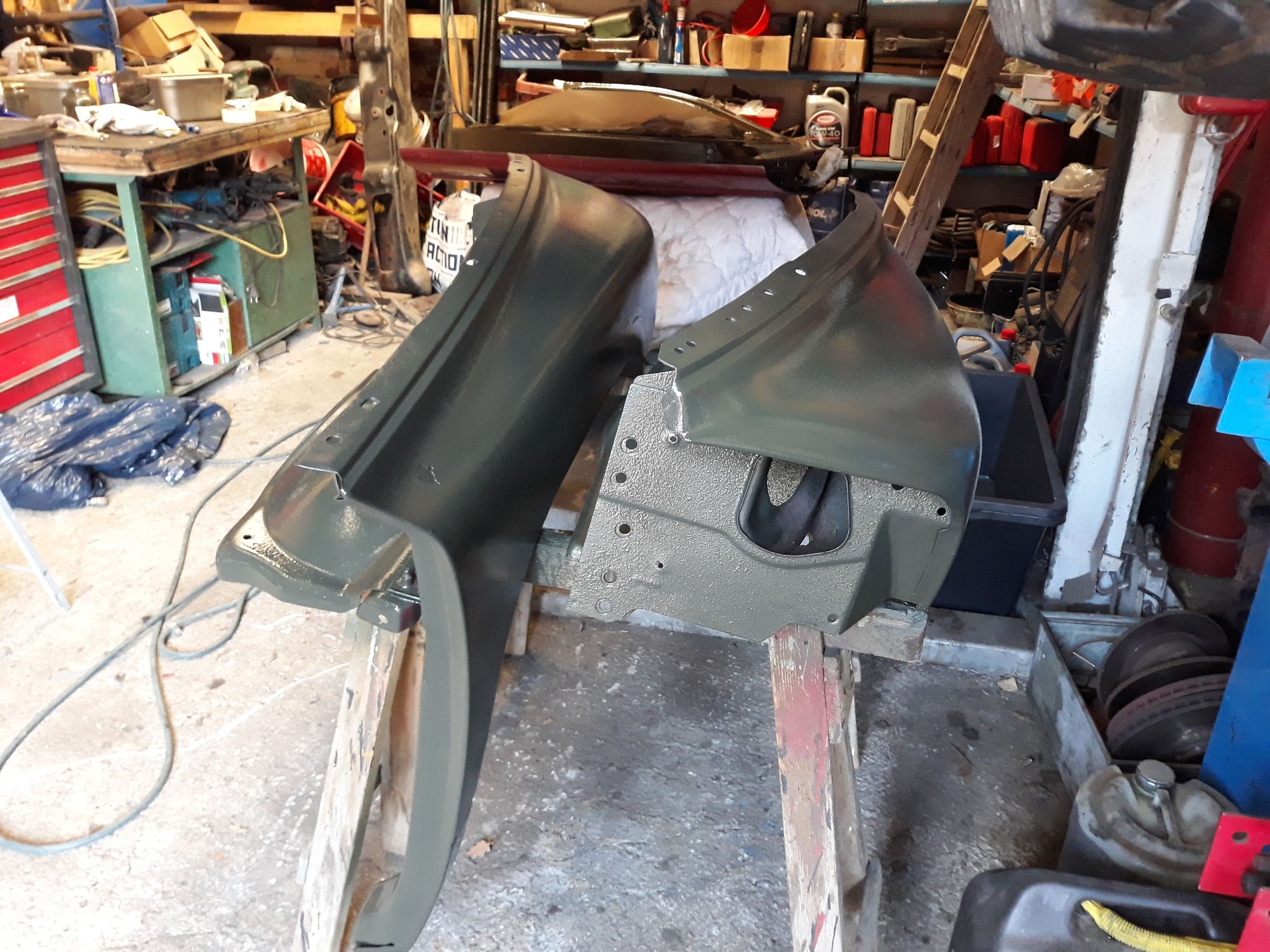

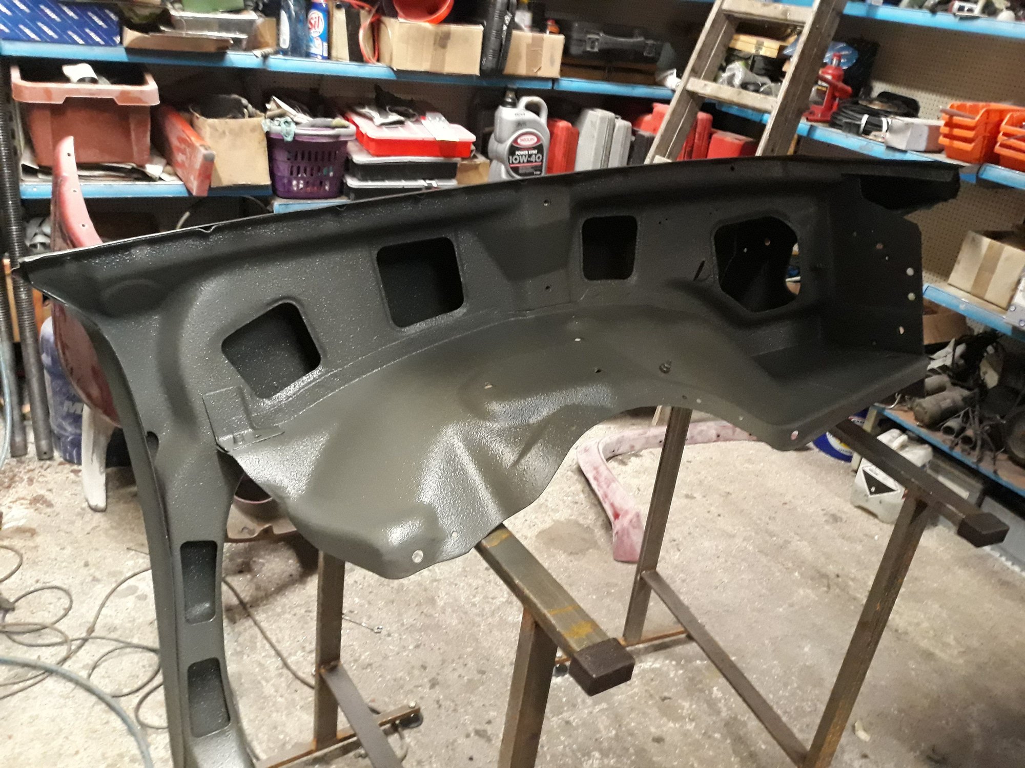

Today I have to practice and test the inside fenders sprayed with Raptor.
With the U-Pol pistol standard.
Mix Raptor Hardener 3: 1, color 10% on Raptor (without hardener) so 75g per bottle.
With a bottle I have not even finished the two inner sides of the fenders, because of the many corners and hollows.
I will also prime the viewing area, that covers better and then does not consume so much Raptor.

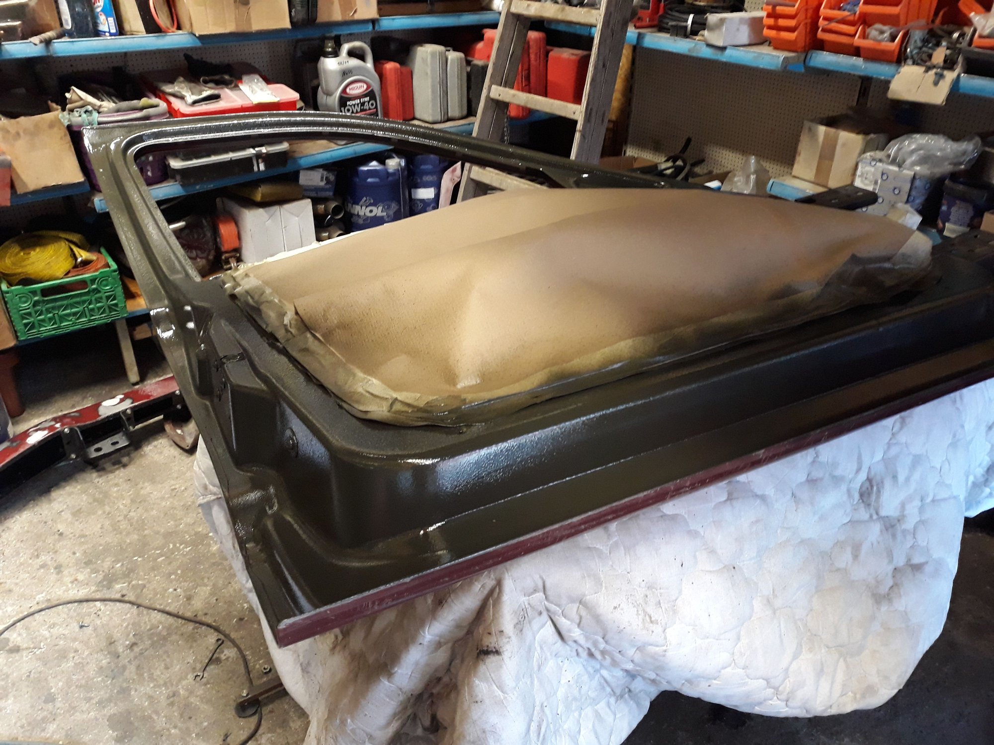

The doors are treated inside with Raptor too.
This mold is sprayed with HVLP gun and 15% urethane Reducer/Thinner at 3.8 bar and 2.0mm nozzle.
The shine is less, color is not dry yet.
Mirror, empleme, paneling, door handle, seal everything dismantled

Are you going to spray the insides of the doors as well? (as in, where all the window stuff is.... which would require removing it all.....) Most of these trucks rust out from the INSIDE.
Old Jan 9, 2019 | 09:37 AM
  #65
Juergen's Avatar
Juergen
Joined: Oct 2018
Posts: 60
From: Germany, NRW
Inside are the doors with wax, are also new doors, the 1st doors are already scrapped

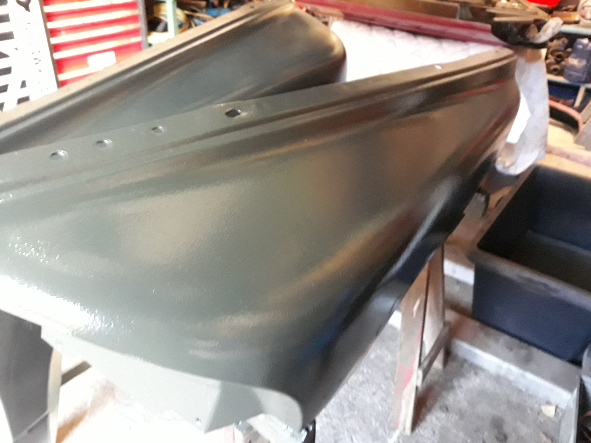

That stuff looks like it leaves a lot of orange peel
Yes it does look that way. If so, I'm not a fan at all.

Underneath and in jambs it's not a massive deal, but it seems like a lot of sanding will be needed on the outside of those fenders.

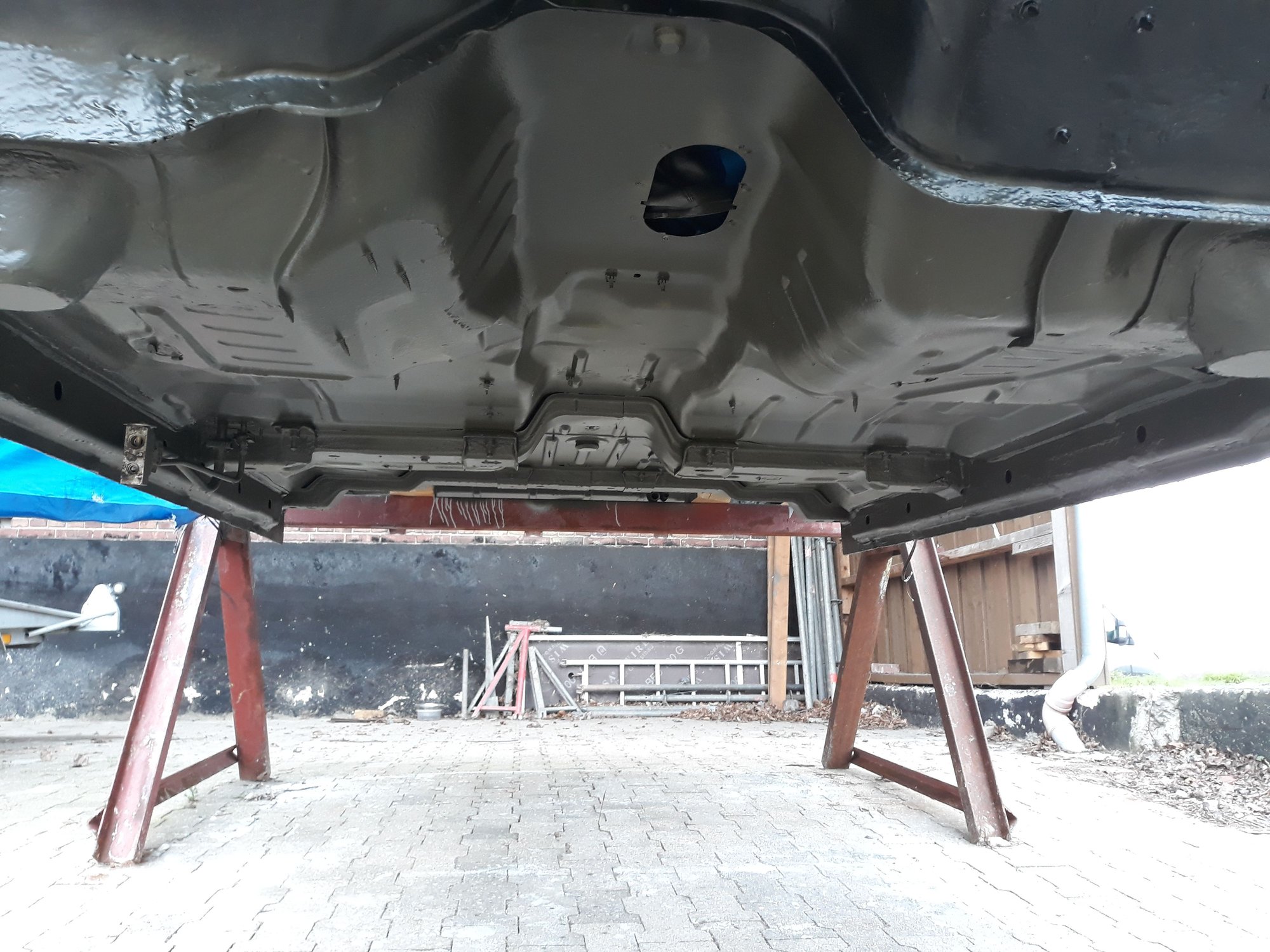

on friday i can do the bodywork and chassis (wedding).I painted the underbody in the color of the car
