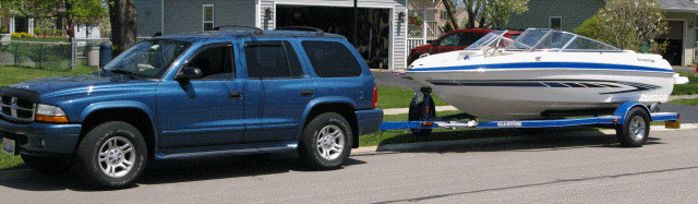

FWIW, My '02 4.3, without the factory tow package had little trouble with my 3200 pound boat/trailer.

Mine didn't either. It it took about a week and "tada" a hitch was there! The trailer electric kit was the "Hoppy" brand I believe. A bit of a pain to install for the 5 flat on the trailer as I had to add a lead for the brake lock out while in reverse gear.
