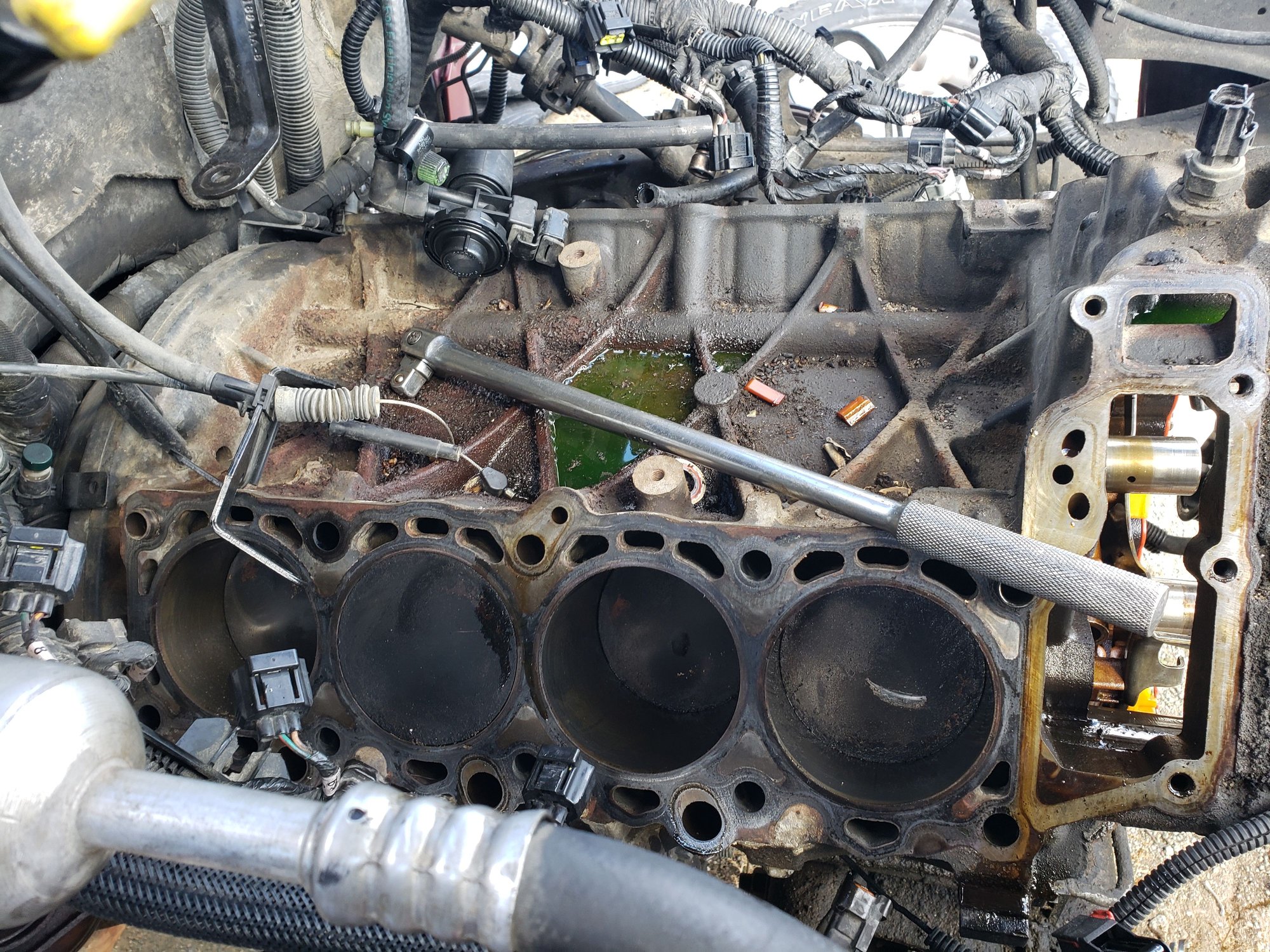

As some of you may have seen, I've been fighting to get my 2000 Durango back on the road...long story short, cylinder #2 dropped a valve seat with no warning....
Today 3/30/19 I finally got the heads removed (doing it all in the car...) and was talking with my dad and he had the crazy (in my opinion) idea of running a hone down the cylinders...he thinks it can be done with no issues...me I think its bad juju...
over all look at the block...the antifreeze was not there when the intake was pulled...the heater lines flopped around leaked on it...the plastic is the broken guides from the timing chains...long story...don't ask lol

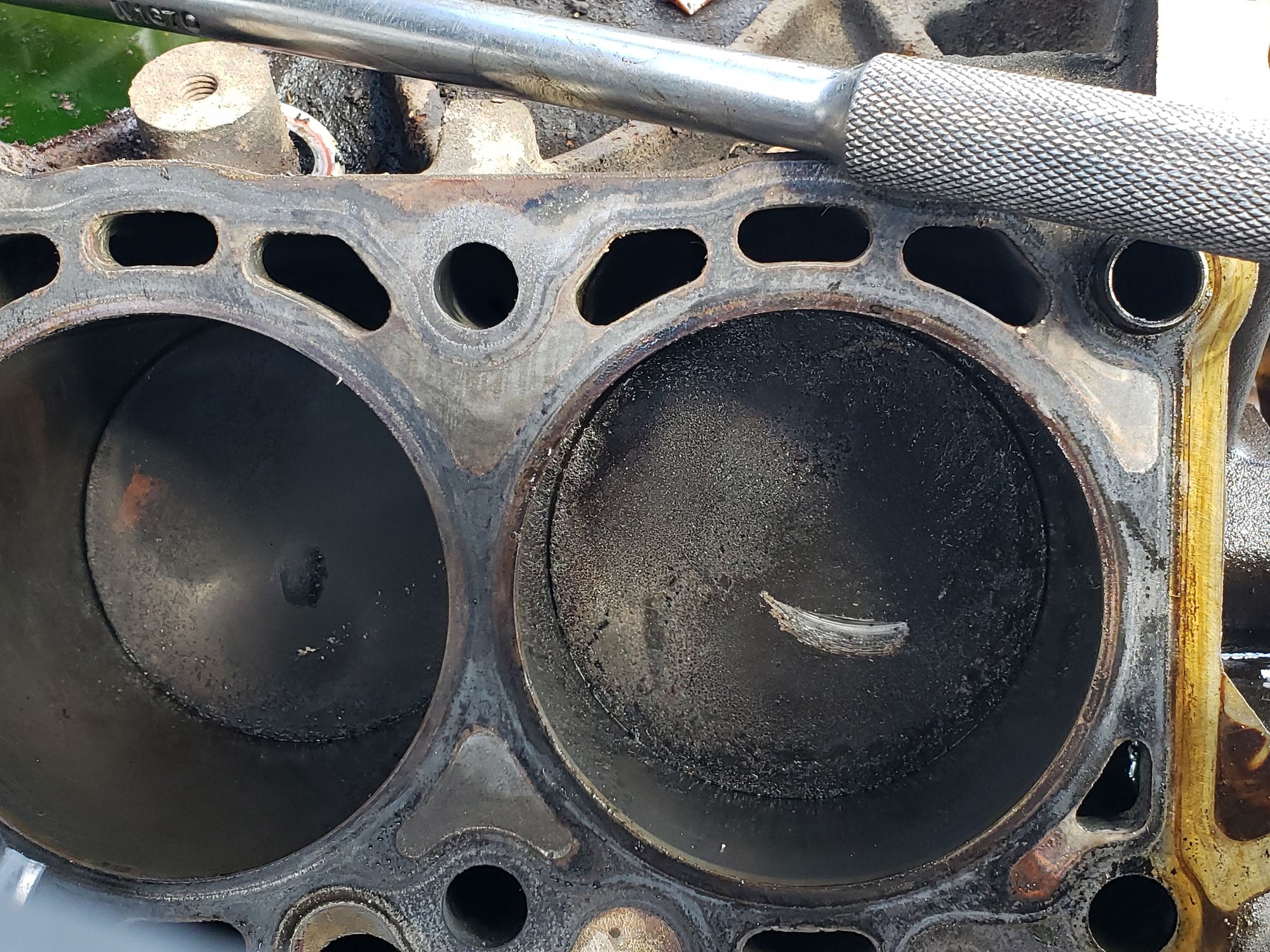

The first picture you can see is #2 cylinder where the piston hit the valve seat...going to try and clean it with some sea foam and or engine cleaner and use the shop vac to remove debris...
From what I have read around the web...honing with the engine still assembled in the vehicle is not the brightest idea...
Genuinely want to hear from the experts out there....
Thanks,
Steve

if you hone the cylinders im pretty sure you would need to replace the rings to get a proper seal. . . . . i wouldnt bother unless you have leakage past the rings

After cleaning the engine, I wiped the cylinder walls and could see the cross hatch marks on them still...so I left them alone...long story short, she lives again

I would never hone a cylinder with a piston installed for a couple of major reasons. One, if you do, you don’t get the whole area of piston travel honed because, well there is a piston in the way... lol . And 2 honing creates residue both front the removed cylinder wall material and sand from the hone that need to be cleaned out. Otherwise it’s like installing sandpaper rings in the motor. The rings can rehire it in a way that is less than desirable...
